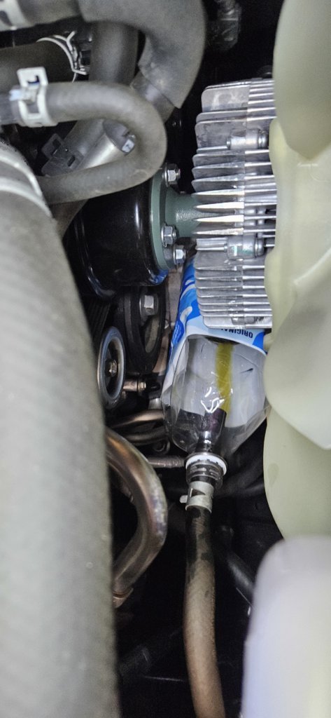

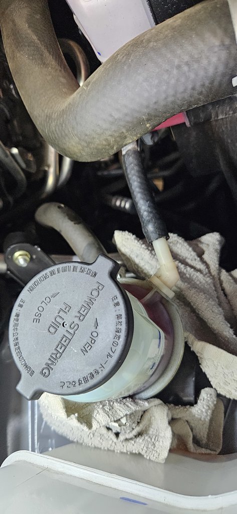

    1. 3/8" vacuum seal cap to cap off the return line on the reservoir
    2. place the return hose in a clear gatorade bottle
    3. With the truck on jack stands and the front tires off the ground turn the wheel all the way to the left
    4. refill reservoir
    5. turn the wheel all the way to the right
    6. refill reservoir
    7. repeat steps 3-6 until you've flushed 3 quarts through the system
    Each full wheel turn all the way to the left or right completely drains the reservoir, so refill it each time or you'll get air in the system.
    The other option is to siphon out and refill multiple times, but you won't get as good of results and you won't completely flush the system. My suggestion is to put the truck on jack stands for this job. It won't take very long and it's not hard to do.
