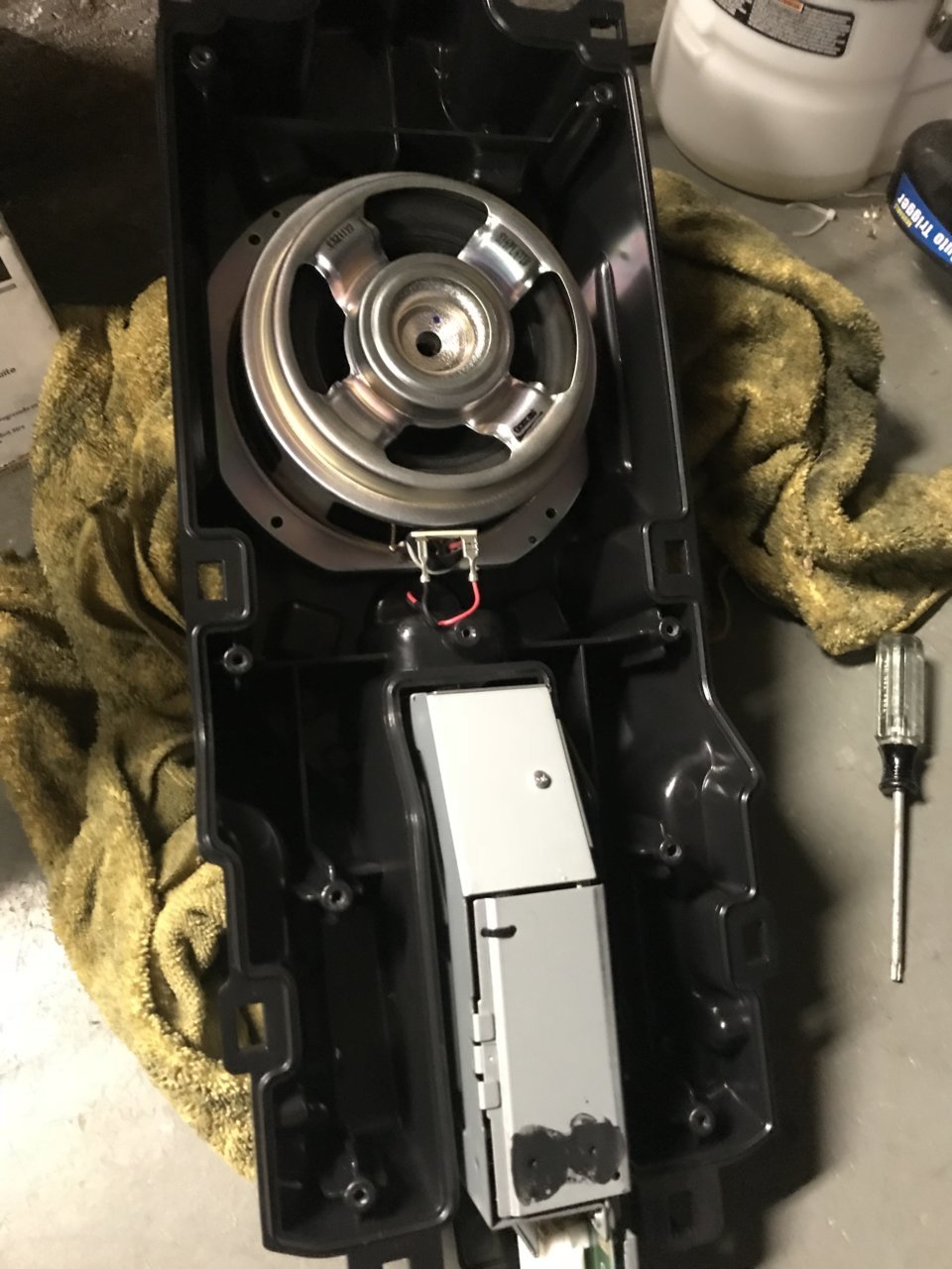

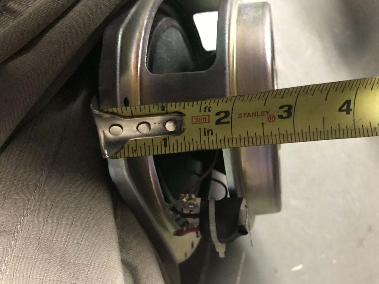

    I was curious if I could change the speaker in it also. The amp is built into the speaker its the silver box in the center.

    Wow, thanks arcenik! That's the only pic I've seen of this "sub" taken apart and measured. I wonder if you could just ditch the metal bracket that speaker is on and just screw an aftermarket speaker onto the stock enclosure. Do you know the screw hole measurements? Like distance from one another? Looks like a 6.5" subwooder should have holes that could match. Also what is the maximum depth and magnet width of a subwoofer that could fit this enclosure.
    I've been scared to take it apart so I dont break anything. I've yet to see a detailed DIY of taking this out and apart. It looks like you could swap in a better speaker, I just want to know the specs. Like ohms (guessing its 4 ohms) and frequency range, RMS and max watts or if the amp has some kind of low pass filter. Also would be nice if someone made a harness that simply could plugs into an aftermarket amp that could be swapped in place where the stock one is.

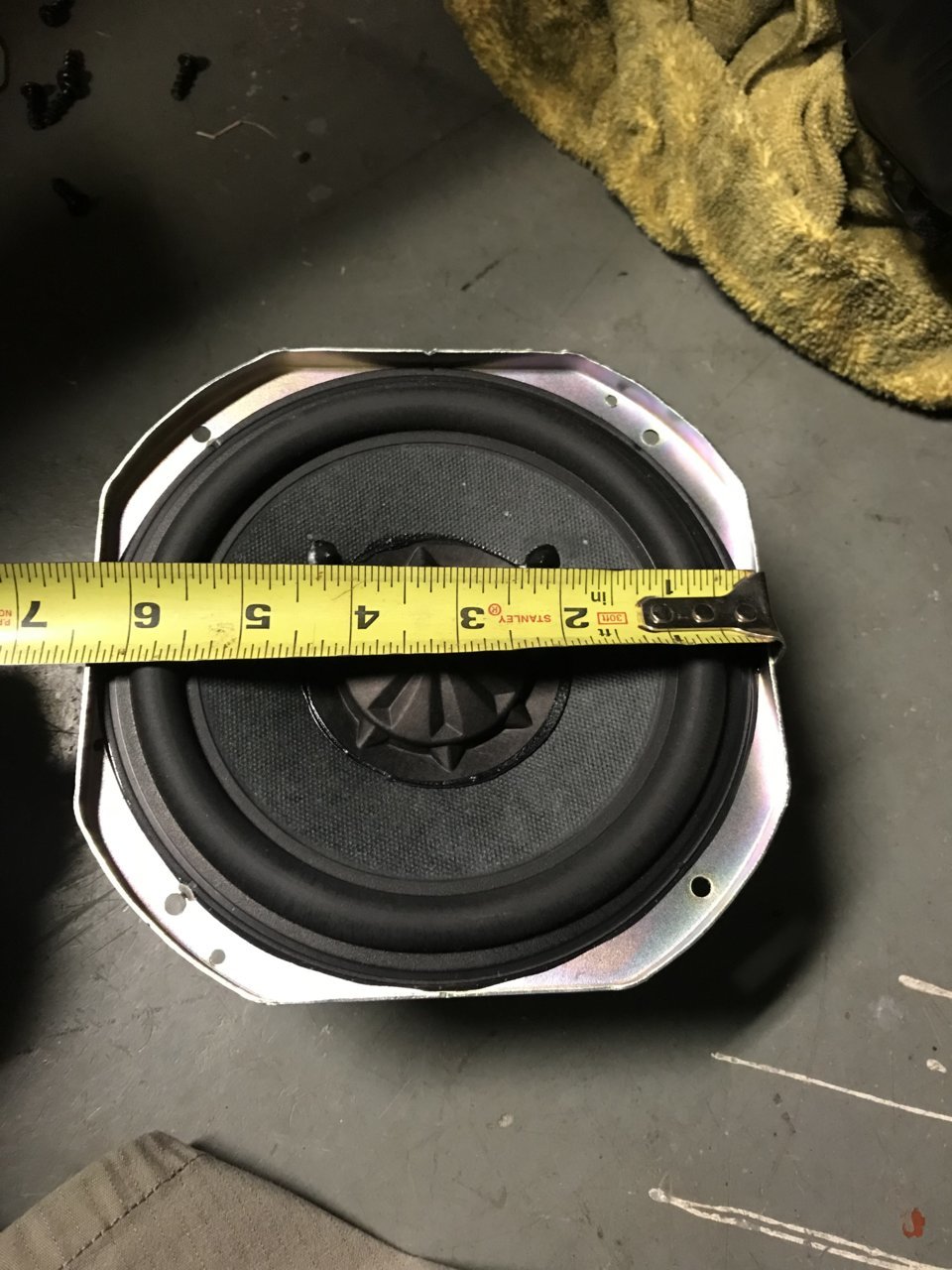

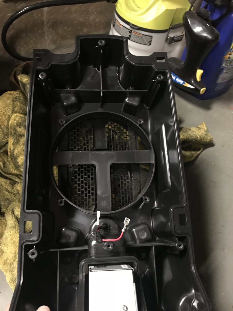

    These are the only photos I took when I had it apart. I was thinking to just ditch the amp and get a better sub for it. But then I thought it might be better to just build another box in the same spot. Let me know if you find something that fits in its place.

    Also it’s hard to see in the photo but it’s not just a single speaker it’s like two speakers back to back hard to explained but you can kind of see it in the photos

    Well, that's weird, that doesn't make sense to me. Wonder what the reasoning of that is. So they're wired in parallel? So basically, I can double the mounting depth of one of those speakers and get a rough estimate of one aftermarket subwoofer than can replace those two, like 5.5 inch mounting depth. It shouldn't matter if its single coil or dual voice coil?

    No the speaker you see is the only one. But if you look good it has a cone facing the front and back. You can see the back one if you zoom in on the first photo. There is only one set of wires running to the speaker also.

    Ok I got you now. So it looks like I will have to find a pretty shallow 6.5 subwoofer (~3") in order for it to fit.

    IIRC there was room behind the speaker I did not measure though. You would need to take it apart to see what fits depth wise.

    That's one speaker and one passive radiator.
    Its basically a speaker without a coil or magnet. You'd be better off building a real box and ditching that plastic mess.
    Any real sub you mount in there wouldn't be sealed properly and would also vibrate the hell out of that.

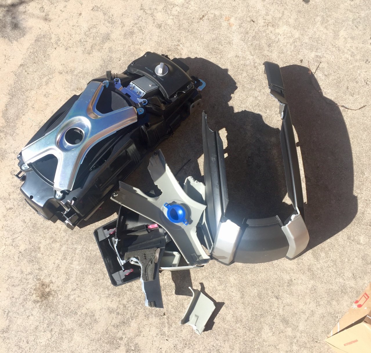

    I have my stock sub out of the car right now and taken apart. How do you remove the little sub/speaker itself I am having some troubles.

    Mine is out - custom removal :)

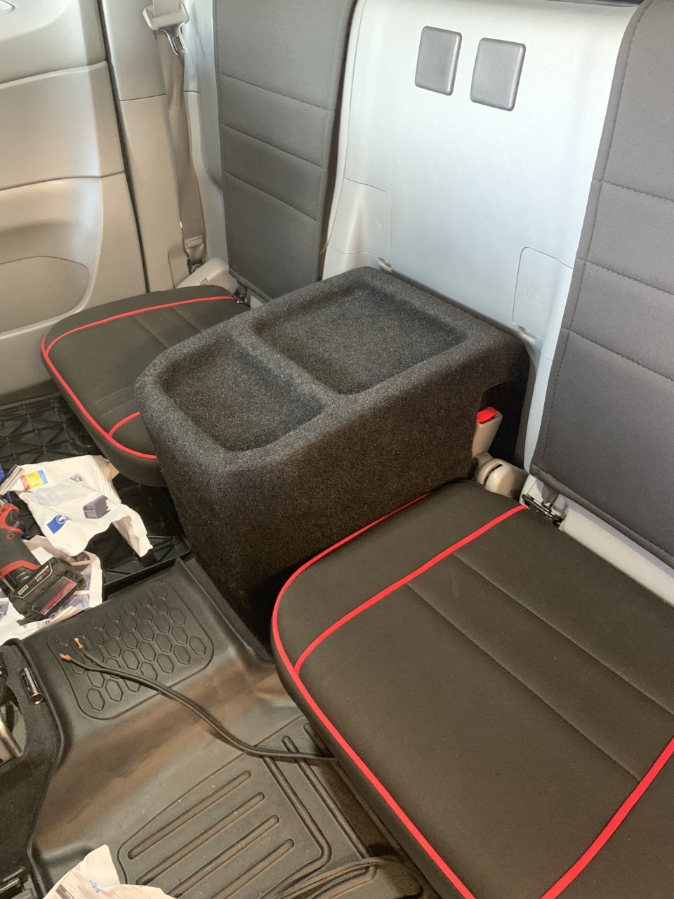

    I ended up replacing mine with a jl stealth box for a 2016. It fits perfectly.
