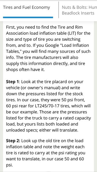

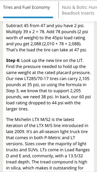

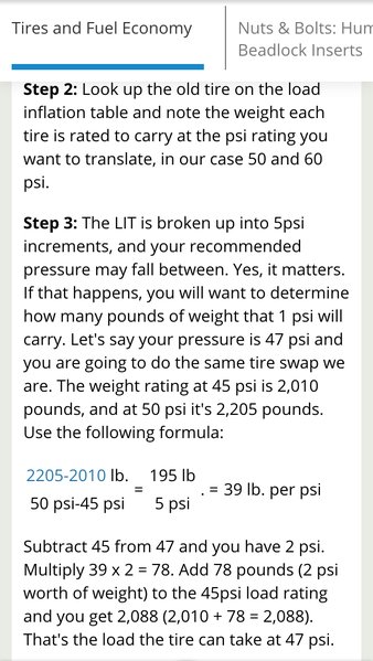

  6. Dec 3, 2016 at 2:29 PM
    jnmargarit
    jnmargarit Well-Known Member
    Dec 27, 2014
    #145035
    155
    Jason
    Vancouver, B.C.
    '14 TRD Sport
    This may help. Although it's a lot to take in. Lol

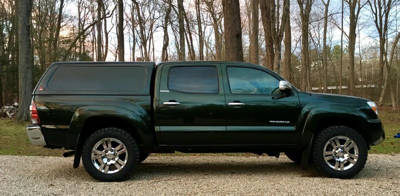

    Nice Spruce!!!
  10. Dec 4, 2016 at 9:44 AM
    GreekHillBilly
    GreekHillBilly [OP] Member
    Dec 3, 2016
    #203934
    5
    2013 Taco Limited
    Thank can0nfan - looks good when it's clean
