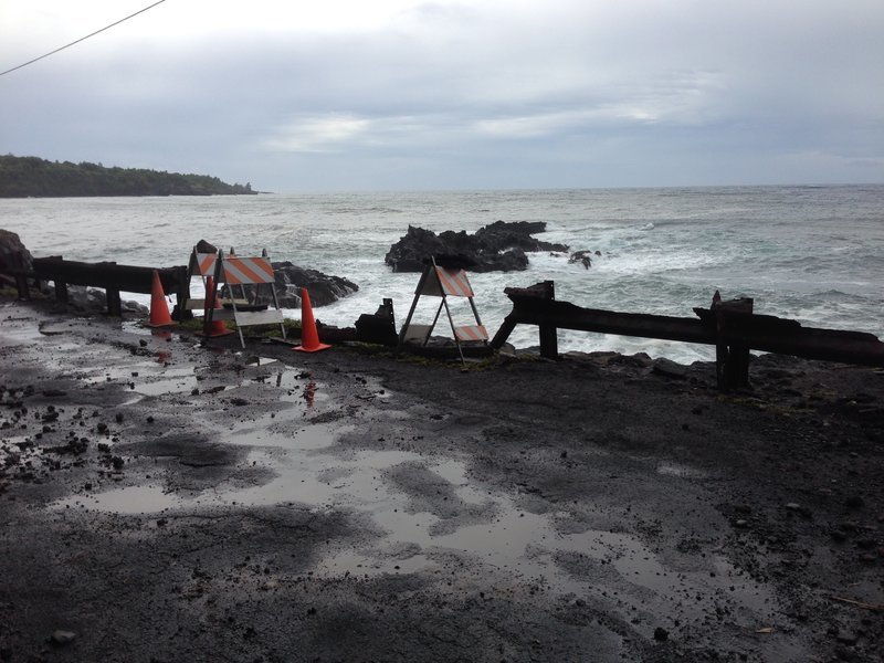

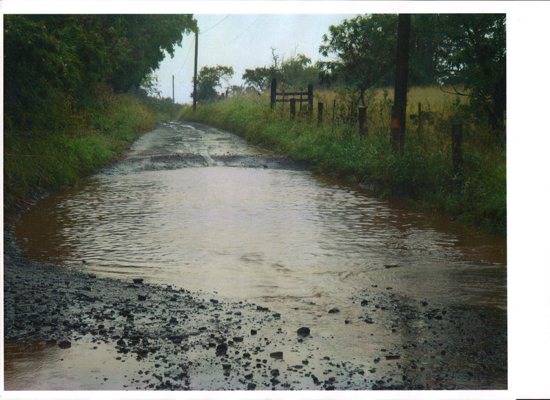

  20. Jun 22, 2017 at 3:54 PM
    #200
    JStarr
    JStarr Life Off the Road
    Jun 8, 2017
    #221006
    382
    Jonathan KH6X
    Kaupo Southeast Maui, Hawaii
    Tacoma 3rd Gen 2017 quicksand TRD OR, T4R 5th Gen TRD ORP silver , Tundra 2000 TRD OR silver, Deere 5300 4wd, Wrangler 1994 ARB air lockers, 1998 BMW R100RTL.
    Around 7% increase in tire pressure from cold to stabilized running temp is an old standard, used by motorcyclists and many car racers for maximum traction. If one is aiming to maximum tire wear and fuel efficiency or carry a load, this would demand higher pressure. If you're after traction and flotation crawling in deep sand and mud, drop the pressures considerably but make sure you can air them back up before you speed up on paved surfaces.
    My '17 Gen3 OffRoad came from the dealer at 33-34 ps, with one psi gain after 2 hours of driving. My ride home has miles of unpaved washboard and deteriorated potholed ancient tarmac sections, and the truck felt jarring at speed, and much harsher than the Gen2 '12, which I always kept at 30psi. Dropping the Gen3 to 30psi with a light load made for a nice, supple and well controlled ride on the bumpy stuff and a 2psi increase from cold.IMG_0849.jpg
