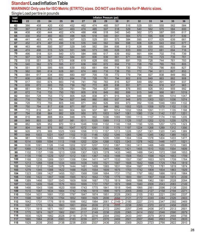

    The stock Offroad tire is a ISO/ERTRO/euro-metric 265/70/16/112 SL. Notice there is no P prefix on the stock tire. You need to use the chart on page 28 to find the weight. A standard load(SL) rating of 112 @ 30 psi gives us a weight of 2,149 lbs.
    Dividing 2,149 by 1.1 gives us 1,954.
    So...
    P-metric and ISO/ERTRO/euro-metric tires require a psi capable of supporting 2,149 lbs, no matter the size or load rating.
    LT-metric and LT flotation tires require a psi capable of supporting 1,954 lbs, no matter the size or load rating.
    IMO, we should never compare psi with someone else; it tells us nothing comparatively speaking. Instead, it makes more sense to say, I inflate to "X" amount of weight and weigh "X" amount over curb weight.

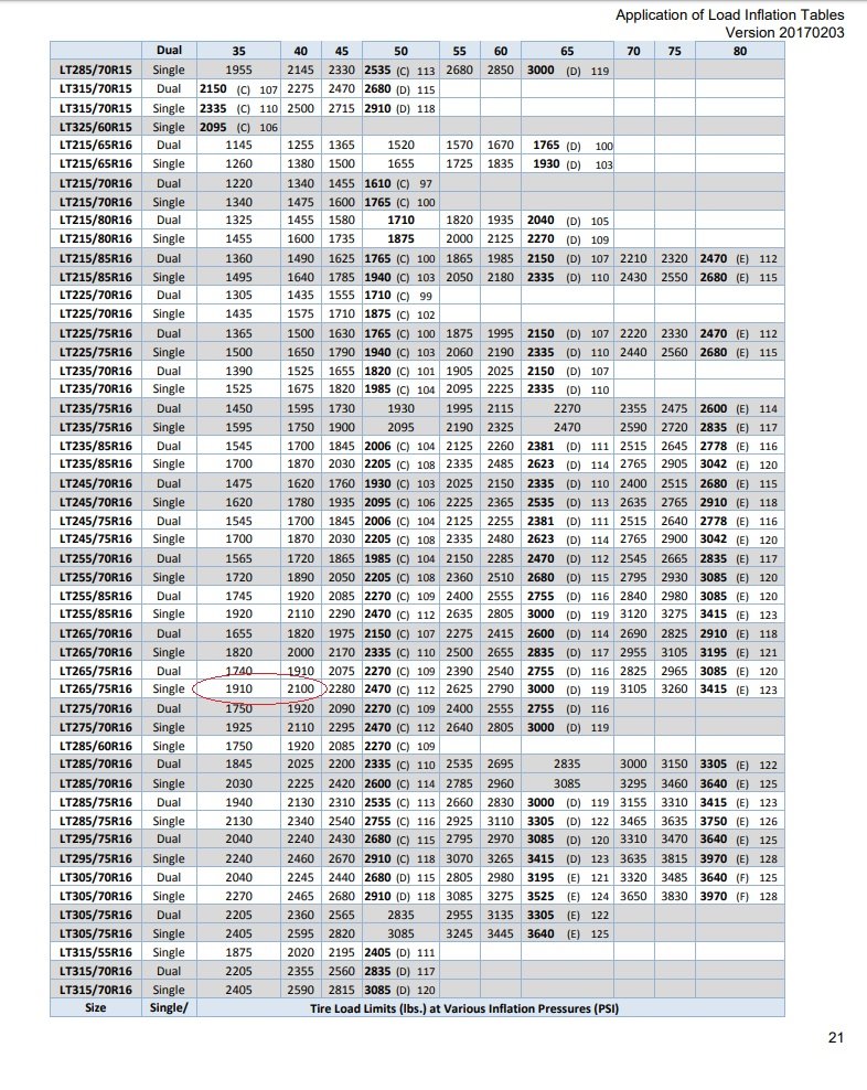

    Since you chose a LT265/75/16/123(E)...
    ...your target weight is in between 35 and 40 psi.
    We have to extrapolate a value for 1 psi between 35 and 40 psi.
    2,100-1,910=190 lbs
    190 lbs=5 psi
    38lbs=1psi
    35 psi(1,910 lbs) + 2 psi(76 lbs)= 37 psi(1,986 lbs)
