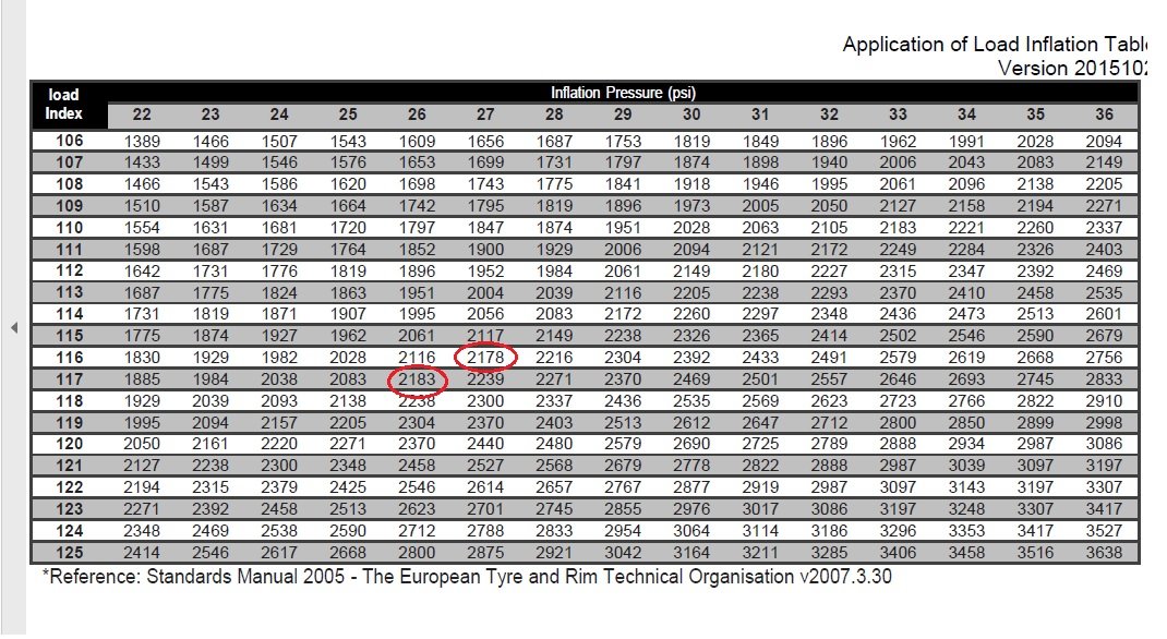

    The psi on the door attains a 2,149 lb inflated load rating from P and euro metric tires; or 1,954 lbs from LTs.
    It looks like 285/70/17s come in load ratings of 117SL for P-metric, 116-117SL for euro-metric and 116-121 for LT-metric.
    2,149 lbs for a P-metric is way off the chart...I'd chalk test.
    For euro metric...
    27 psi for 116 load rating
    26 psi for a 117 load rating
    You could extrapolate a value of 42 lbs/1 psi between the values given for 35-40 psi.
    This would give you 32 psi and 1,979 lbs of inflated load rating.

    Sorry to bother... what's the recommendation when fully loaded for adventure? Also since I have you, what would you recommend airing down to after driving on highway for several hours (because, California) when we get to trails?
    Curious about 37psi, not that I doubt you and you seem really knowledgeable - the tables above don't seem to even go that high. What's the science behind it? Thanks much! Owe you a beer in the brave new world haha. Sis lives out your way.
