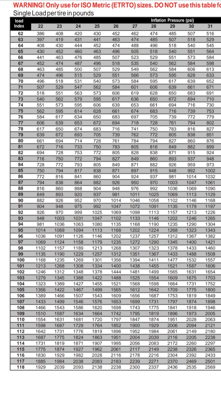

    Inflating for mpg and ride comfort seem contradictory, no?
    It's GVWR x dynamic load & safety factor = inflated load capacity
    The placard has a 2,149 lb load inflation for P and Euro metric tires. This translates to 1,954 lbs load inflation when an LT is used.
    Dynamic & safety load factors:
    1,400 x 1.54 = 2,156...P and Euro metric
    1,400 x 1.40 = 1,960...LT
    This is the load chart for a euro metric 112 SL; what comes on the Offroad and Pros.
    According to you, inflation psi would be below 22 psi. Notice the load capacity at the recommended 30 psi; 2,149 lbs.
    Greg.Brakes.Tacos likes this.

    It only seem contradictory if you consider that low tire pressure would not be comfortable driving then MPG/comfort work together.
    I think I missed where the 1.54 and 1.40 saftey factors came from? You may have said it before in the thread but I am sorry I missed it.
    I am not trying to say that your extra saftey factors are wrong I am just saying that if you have an LT tire I think that you will be over inflating it and it will be a harsher ride than you will need for Load.

    Sorry I understand how the chart works it is taken from the "ETRTO manual" which is for european tires. I am just trying to understand where the Dynamic & safety load factors (1.54 and 1.4) came from? I am pretty possitive that those load values are dynamic load conditions.
    I am not suggesting that you run your OE tires at 22psi but you could run the tires on your vehicle at 22 psi with the tire having issues. Although You wouldnt want to do this for the lifetime of the tire.
    I am not stating to run at minimum pressure what I am stating is that when you convert SUV to LT tires they are not created equal thats why I am trying to understand where your saftey factors came from.
    I think the confusion is coming from that fact that you are trying to use the placard psi to determin the load that the tires need to be and I am trying to say they dont need to handle that much load. They are putting the tire pressure that high for handling, mpg, and comfort.
    Take a look at the sticker to the right of the placard it says Front Gross Axle weight is 2,755 lb or 1,377.5 lbs per tire. Rear gross axle is 3,110 lb or 1,555 lb per tire. This is the most weight you should put on the front and rear axle.

    You're saying inflate to GVWR...or 1,400 lbs at each tire.
    The stock tire(a euro metric 265/70/16/112) at it's recommended 30 psi is 2,149 lbs of load capacity...
    2,149÷1,400=1.54
    An LT only requires 1,954 lbs load inflation because euro and P metric tires are de-rated for use on suv/trucks.
    2,149÷1.1=1,954
    1,954÷1,400=1.40
    If you want to disregard it for the reasons you mention...I'm not going to try to convince you otherwise. But, there it is.
