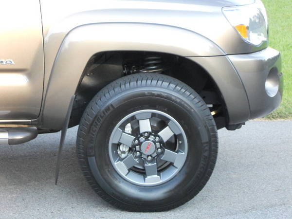

    3m clear bra or Venture, stant locking gas cap, Shield, front windows tinted, weathertechs, ARE "Z" topper. Sockmonkey decal, Billy 5100's x 4 corners, Eibach coils, Toytec 1.5 AAL. Michelin 265/75/16 MS2's, Grillcraft MX series/TOYOTA badging. FJ/SE TRD Anthracite gray wheels. Katzkin leather/heated seats.
    35 psi all the way around.
