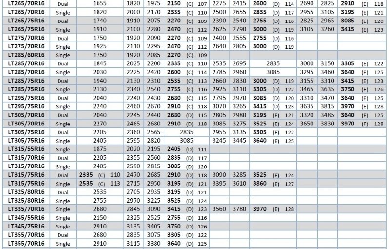

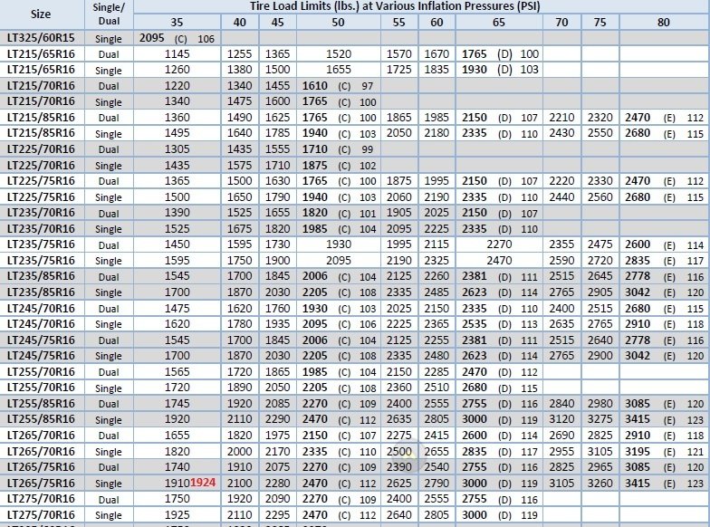

    My stock Goodyear Kevlars P265/70/16 have a 112 Load Index and the placard recommended tire pressure is 30 psi.
    This gives me a load requirement of 2,117 lbs; 1,924 lbs after FMVSS 1.1 correction factor.
    I replaced with BFG LT265/75/16 Load E and run 36 psi.
    Had I chosen;
    -LT265/70/16/37 psi
    -LT285/70/16/33 psi
    -LT285/75/16/30 psi

    36psi? why? i think the chart means you need that psi for the sidewalls to carry that load, no? if its just truck load then 34psi should be about max ??
  11. Dec 22, 2015 at 10:23 PM
    #151
    splitbolt
    splitbolt Voodoo Witch Doctor
    Mar 7, 2010
    #32761
    7,858
    NW Arkansas
    2016 TRD OFFROAD DCSB MGM
    I require 1,924 lbs.
    35 psi would only give me 1,910lbs.
    The difference between 40 psi and 35 psi is (2,100-1,910=)190 lbs. So, 1psi=38lbs.
    1,910(35psi)+38(1psi)=1,948(36psi)
    1,910(35psi)-38(1psi)=1,872(34psi)

    I have the same truck and tire as you; I run 36 PSI.
    Yes, 36 psi, is a higher pressure than the vehicle tire placard(30 PSI), but these aren't stock spec tires.
    Anytime you change tire size and/or load spec, the PSI on the vehicle tire placard no longer applies.
    We changed both.
    The load rating of the stock ISO-metric 265/70/16/112 @ 30 PSI is equal to a LT265/75/16 @ 36 PSI.
    Here's a pdf link explaining further;
    https://toyotires2-1524598101.netdna-ssl.com/assets/lib:toyo content/Application_of_Load_Inflation_Tables_20151020.pdf
