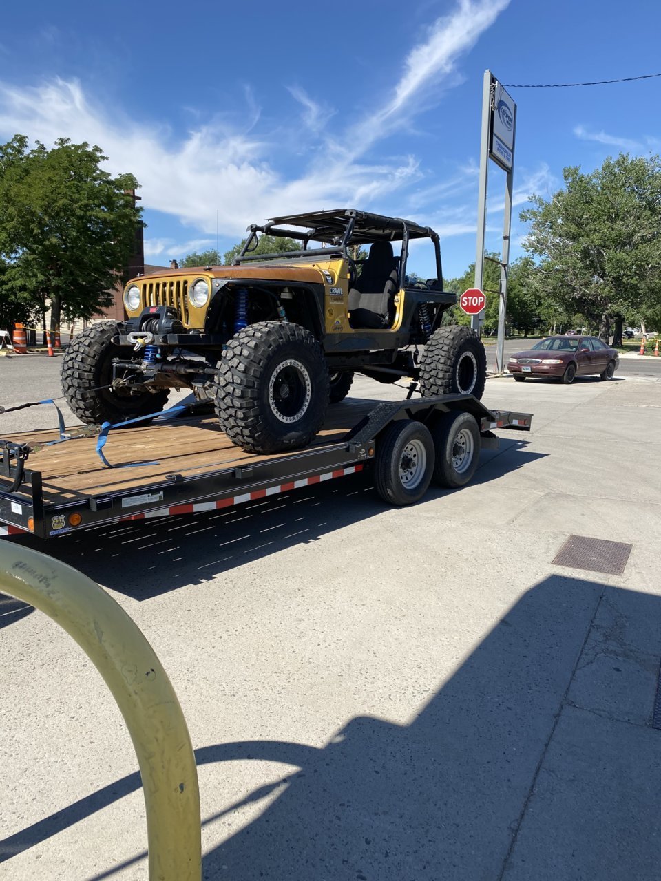

    I have popped a tire bead a few times (even with beadlocks, inner bead), so have a way to air the tire back up. Starting fluid and ignition source works...FYI. I also bring a nice CO2 tank along if needed.
    To answer your question, 12 psi and you should be good unless you are taking hard turns in sand. Might roll a bead off the wheel. Depending on tire size, this can make your differential a boat anchor.
    For reference, I keep my front at 10 psi, rears at 9 psi. Jeep is a fatty at 5300 lbs.

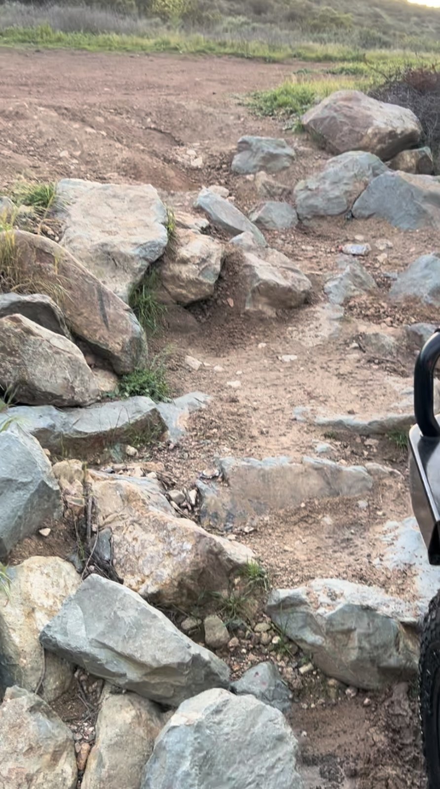

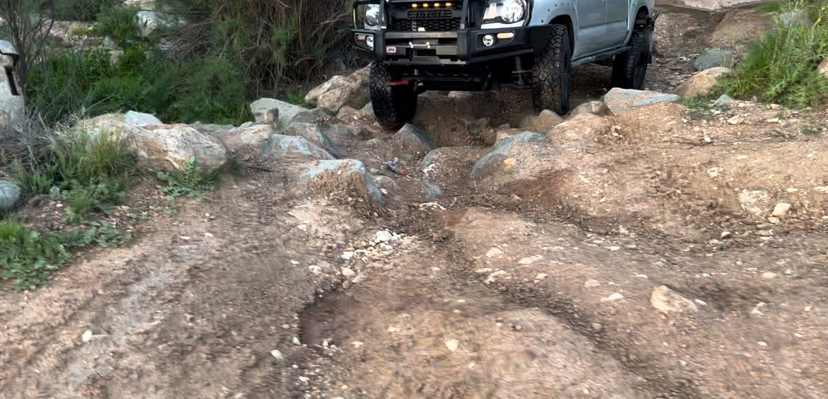

    aired down to 17psi which seemed good until I hit this surprise at the end of a trail
    steepness not shown in pic
    Wish I tried lower PSI to see if that helps be easier on the clutch getting up
    anyway, didn’t want to mess with million mile wiring of ViAir 88P taking forever in the dirt and worrying about it falling over after on the floor super hot
    instead drove like a mile to gas station air used that
    Is that bad? Kept it under 45 if not 35mph on the way there
    im hoping not
    4Runner behind me at Black Bear Pass driving said he didn’t even air back up to make the road drive to Imogene and was fine
    so far only noticed one tiny damage or two to a single tire but guessing that’s from a rock and not aired down enough, and/or steel bumper or something not trimmed enough. Still working it out trial and error
    was max 2nd gear 4HI on flat parts in hindsight maybe should’ve went slower there or ran higher pressure during that section

    I have the method bead grips and am now in the 9-13 range with Patagonia MTs. I've gone as low as 6 in the snow. All slow driving. I have one trail spot where the back tires would skip/hop when at 15. At 10 it crawls right up. Definitely worth experimenting and if you have a 5th tire on hand you're OK if you slip a bead.
    .. and to the question a few notes up about 1 mile at 17psi. not an issue.

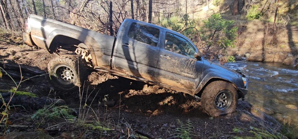

    17-20 psi for dirt roads at moderate to fast speed.
    10-13 psi for rock crawling.
    I popped a bead for the first time at 11 psi. It was my driver rear tire. I was taking a sharp corner and there was a rock pushing hard into the side wall. Only a small portion came off. I jacked the tire off the ground, put a ratchet strap around it, then aired it back up till it popped on. Not sure if the ratchet strap was needed but I saw that trick somewhere so that's what I did.
    Tires: Yokohama geolander Mt-35's
    Wheels: SCS 17×9
