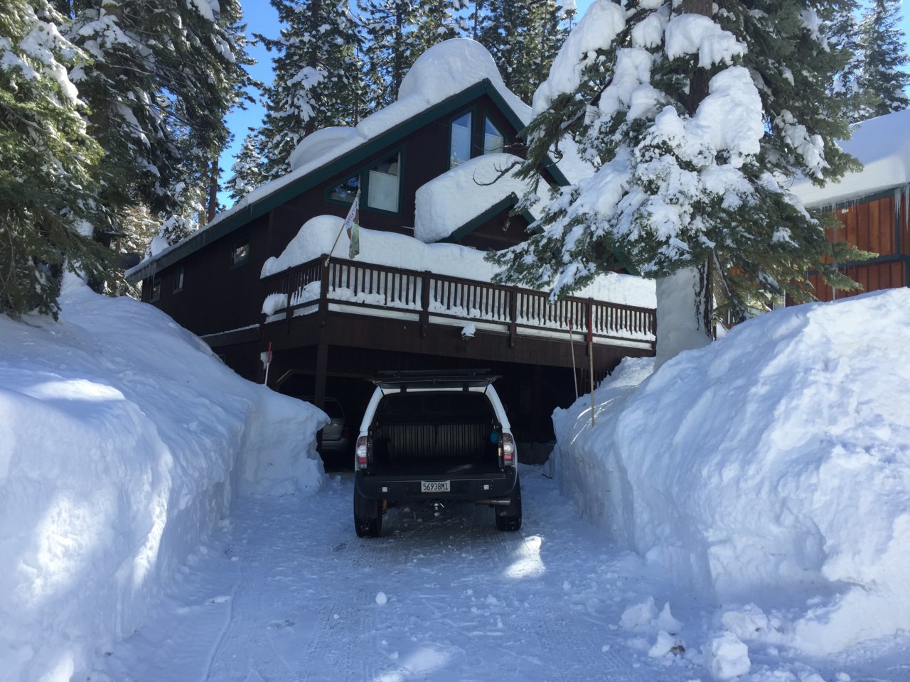

    I added more to my post, maybe worth .02.
    Maybe not.
    Here’s the only pics of my truck I have left. I had approx. 2.5-2.7 inch of lift up front.
    hella_tacoma[OP] likes this.

    Damn... That's lot of snow!
    The highest we had was 16"
    I can't imagine if we get that much here.. I might be off from work for so long if that happens.
