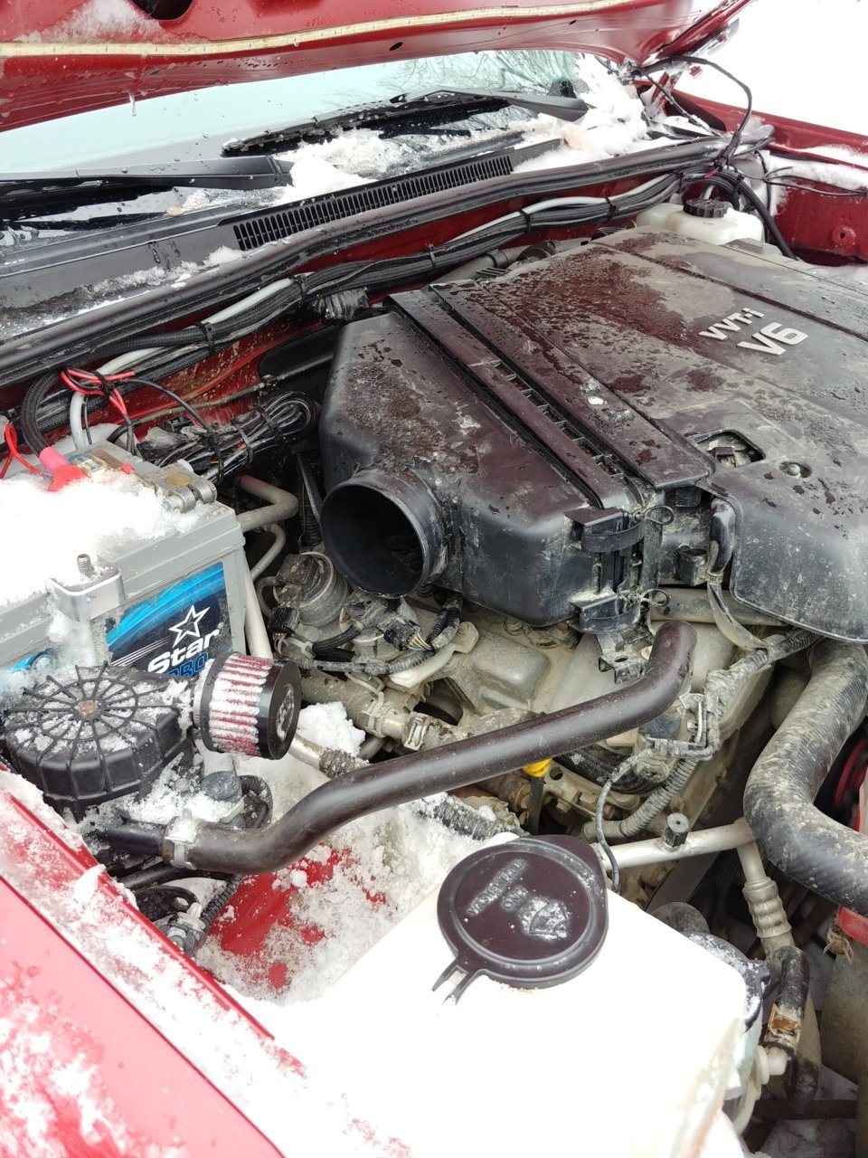

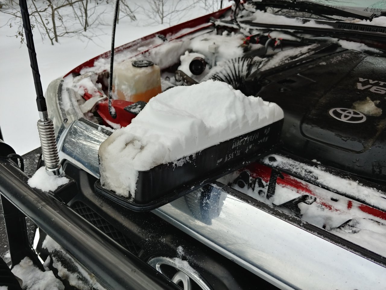

    The only ones I can think of right off for myself are both snow related and pretty minor. Got into a situation early last year where the snow was not only real deep, but also very fine and powdery. Ended up sucking a lot of it in the intake (probably due to my speed :D) Noticed a huge drop in power over the course of a few miles. Figured I could just clean out the filter and keep going. But it kept happening more and more as the snow got deeper. Eventually decided to pull the intake, everything pre filter. Not a huge task, but still takes while to dig all the tools out, dig all the snow out, etc. Unfortunately that didnt help it from also filling up the cabin filter though haha

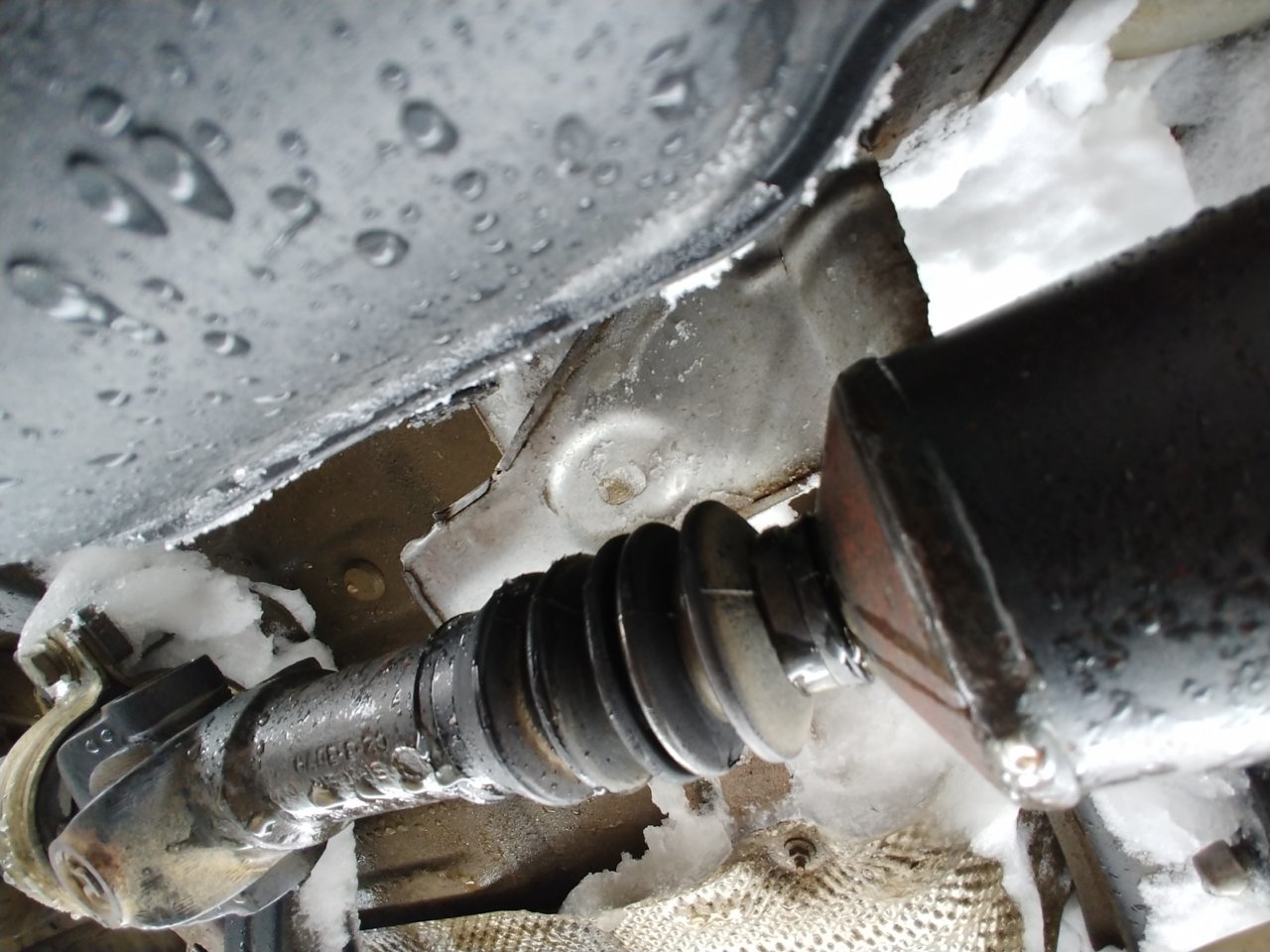

    The other one was new years this year. Wet sticky snow packed up between the gas tank and that stupid little heat shield flap thing, pushing it into the slip yoke boot. After it cut through the boot and semi wrapped around the driveshaft I could hear it. Had to stop and cut/rip the damn thing off. All while snow and dirt and shit is melting off and dripping in my face. Talk about a stupid design..
