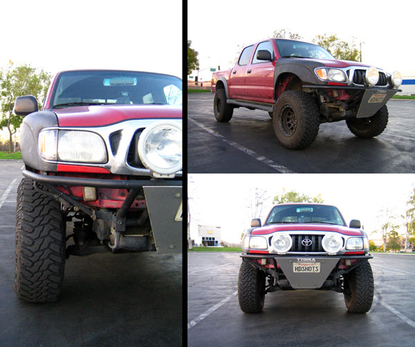

    on a first gen, you don't need hub centric, and most wheels that are hubcentric from 4WP seem to be for chevy center bore and are not big enough for the tacoma...
    if you want the simple rock crawler style, look into the D Window black steels in a 4" backspace in 16x8 or 3.75" backspace in 15x7...
    if you want to go a bit more extreme, you can get the same wheels in as low as 2.5" backspace...
    you can run a 4" backspace on stock arms and then go with some 3.5" flare glass fenders and the wheels and tires will sit flush... in these pics below, i had 4" backspace black steel D Window wheels from ProComp with Cooper STT 285-75-16 and glassworks 3.5" glass fenders...

    ^^this looks good! so u saying if i run the procomps with the 2.25 backspacing and there not hubcentric, then the should still work??:D

    2.5" backspace might be too much... i say stick with 4" or 3.75" at most...
