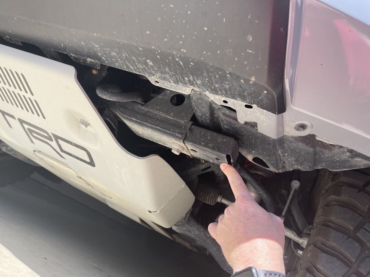

    Anybody mount your front cyclones here. maybe magnets, but I want to try to utilize these holes but they’re not threaded and just trying to figure the best route

    That’s exactly where I mounted my cyclones with the included brackets.

    A384E7EB-CEB1-4350-A878-BC9E5BD07ED4.jpg EAD74F55-EF9E-4C27-AF0F-7BA71C8FEEB8.jpg 11816C95-0459-4458-86AE-BD584A59ABC8.jpg 45D88179-74F8-445E-99B0-721BC6D6595E.jpg
    The first two photos are from the location up front drivers side that you asked about. You can remove silver bolt you see in the photo and slide out that section which gives you access to the hole for the bracket you see in photo 2. Photo 3 is the driver side middle of the truck. It’s mounted to the frame support that goes over the carrier bearing just forward of the gas tank skid. The last photo is driver side rear. This is up in the corner. All of the holes were existing. Didn’t need to drill anything. Pretty much the same locations on the passenger side. I didn’t see the need to add those photos. But if you want them just say so.
    Also, if you go with the cyclones the kit will not have long enough wires. So make sure you pick up a small spool before you start the project if you don’t have any on hand.
