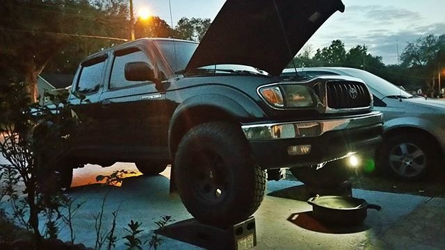

    Would yerr believe me if I told yer that shes been running the stock suspension for almost 200,000 miles now? haha nah but really stock suspension stock tire size bud 265s I just got some wheels from Procomp (Series 7069, 16x8 6 on 5.5 bolt pattern - flat black) to be exact. With beefier tires. Whole thing including wheels and Tires ran me about $950 cant beat that price. Love them. No extra strain. Runs amazing. I do want to lift but not now. Maybe when I get tired of these wheels and tires.

    Here are a couple of pictures.

    Wow. They looked like 285s to me but maybe it's just the pic. Are they a 265/75 cause if so I may just get that. They look great

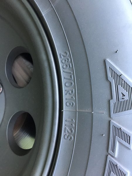

    Here are a couple of shots from different angles and the name of the tires. They are 265/70/r16. Although, I am sure you can get away with the 265/75s Im not sure why I dint go with that option. Maybe it had to do with the tire rubbing when I turned and so the mechanic guy told me it would be better with 70s or maybe this tire did not have that option I'm not quite sure. You're gonna have to look that up. But they do look good I love it. Thank you.
