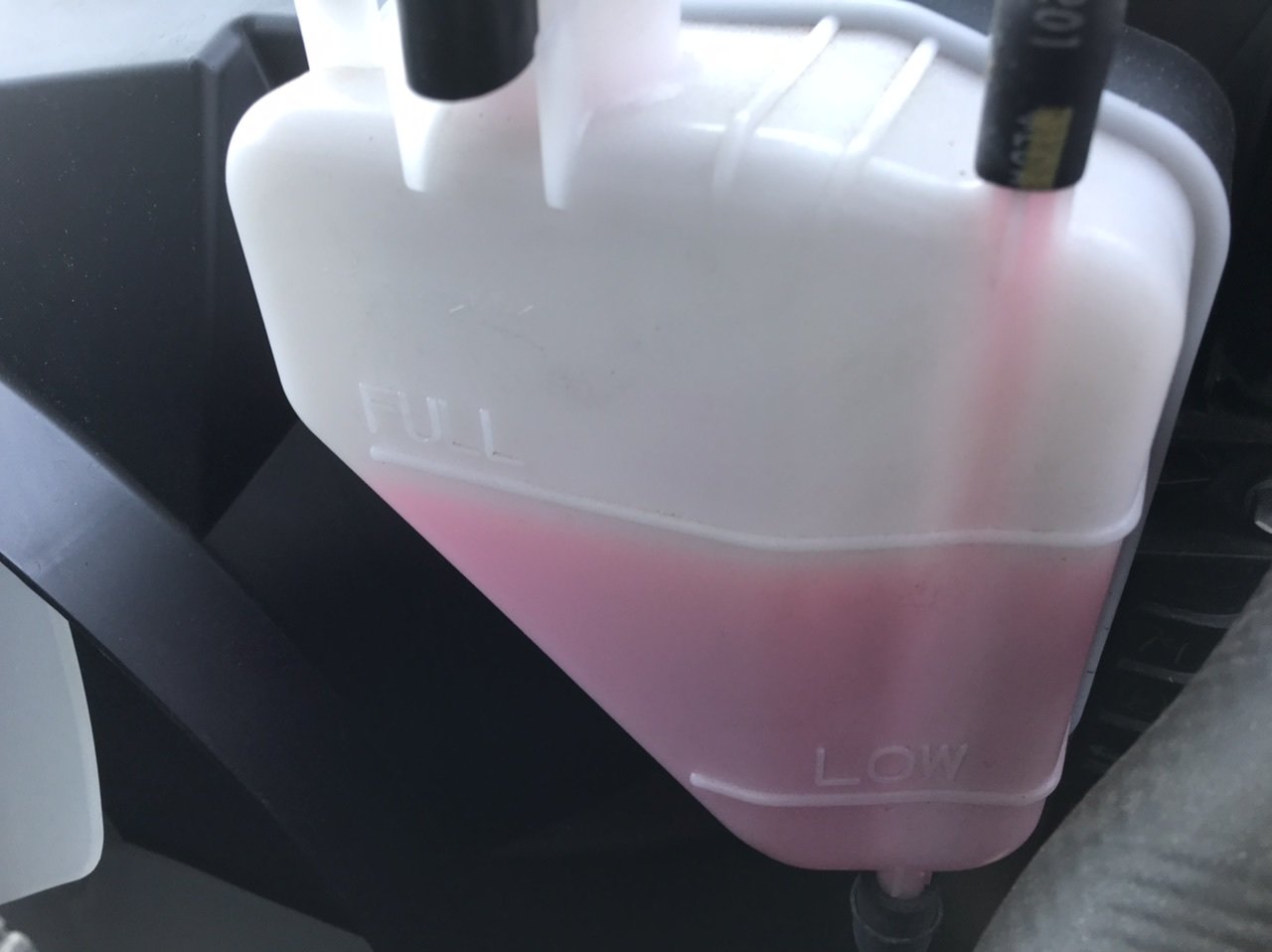

    Agree with the last parts of your posts, but the reservoir lines part I don’t. My 2.7L has a Low and Full line on the coolant reservoir tank. Some vehicles have a L(low) or F(full) or on an Accord some have a Min and Max line. In both cases at service its said to add to the top line with engine cold. It won’t overflow when the engine is warmed if it was filled only to the top line when cold since there’s plenty of volume left above the top line. A level anywhere between the two lines is ok but you don’t want it to run low so best to fill to the Full line during service.
    https://parts.olathetoyota.com/blog/4476/radiator-fluid-levels
    https://practicalmechanic.com/2019/02/17/how-to-add-anti-freeze-coolant-to-a-honda-accord/
    Here’s a picture of mine with the engine cold, 11 months since last service and likely has been at this level since I bought it. With the engine warmed no significant change, its not a hot summer day but it’s not gonna get very high even then.

    the truck takes a lot of coolant. The majority of it is inside of the engine passageways and radiator. It acts like a sealed system there where the radiator cap is under pressure when hot.

    Correct. The discussion was about the coolant reservoir fill lines.
