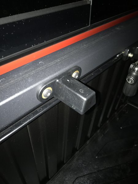

    I've got a couple screw holes in my bed (see photo). I think something went there but don't know what (bought the truck used). I want to plug the holes to prevent rust. Tried to get some screws from Home Depot, but they didn't fit and didn't want to cross thread. Is it special Toyota hardware?

    I think its the mounting point for the bed cover

    I think I read somewhere that they're for a bed cover.

    factory tonneau cover

    Plastic piece to keep tonneau cover aligned goes there.

    Those 2 holes are for the cover as said above, the other holes can be used to mount a 2nd Gen track.

    All of the bolts on the Tacoma are metric, and those two threaded holes accept M6 x 1.0 bolts which is not a special size metric bolt, and they be found at any good hardware store. Let me take a guess that after looking at the threads you tried screwing in 1/4-28 SAE bolts.

    Thanks. Yes, I think the ones I tried were standard.... I was looking for stainless and didn't see metric in stainless.. ill have to try locating some stainless ones in metric. Thanks again!
