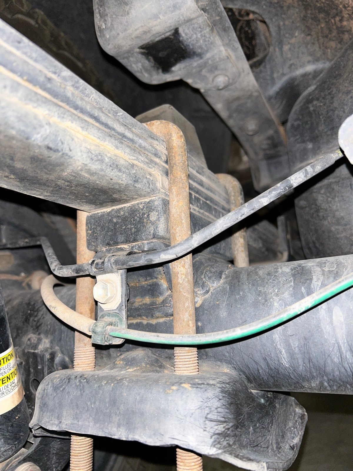

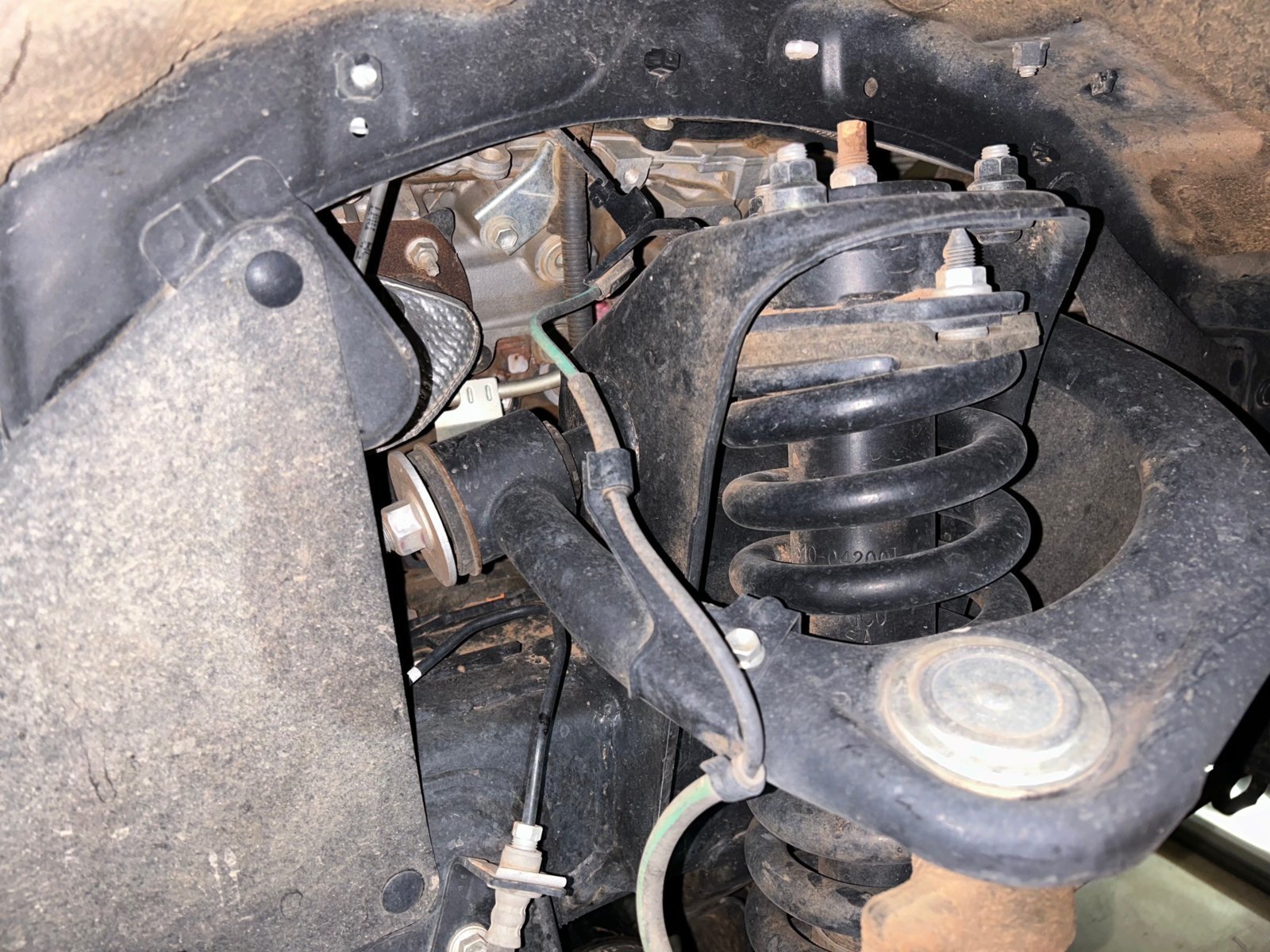

    It came off the showroom floor with 285 tires and a dealer\port installed lift. I have no documentation on the lift kit. I *think* it is 3" on the front and 2" on the back...but that has been six years ago.

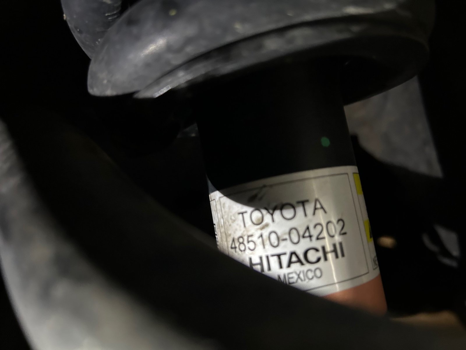

    Front Left Hitachi 48510-04202
    Front Right Hitachi 48510-042?0 (label damaged)

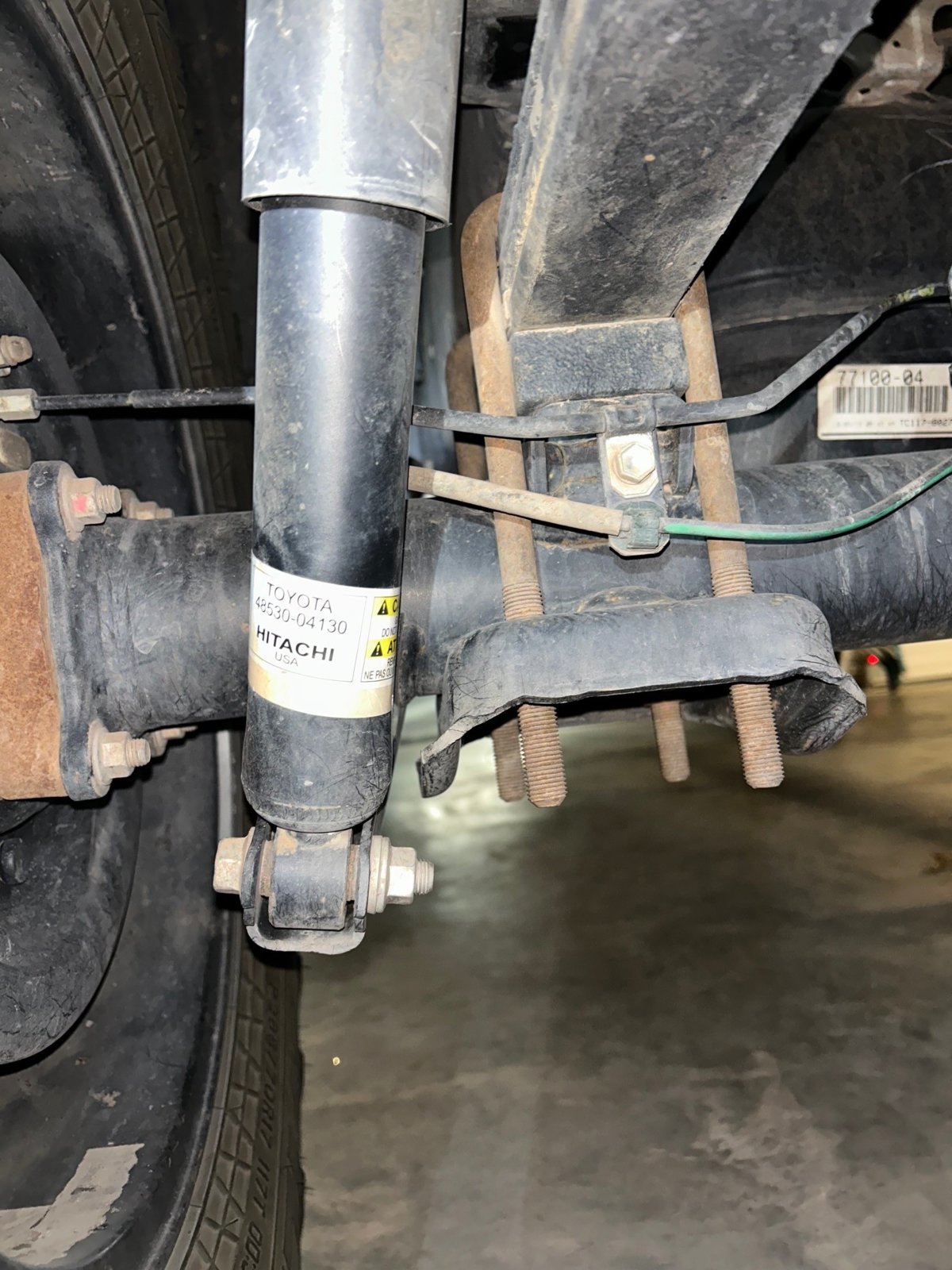

    Right Rear is 48530-04130

    The shock part numbers are visible and marked "Toyota Hitachi" but I have had zero luck looking these up, including on the dealer's parts search.

    In front shock picture, there appears to be a stamped part number on the upper part of the shock...I'll try to get that entire number.

    Those are original sr5 shock

    You are in fact, running standard shocks.
    They just added the cheapest lift on the market which are simply blocks on top of your factory suspension.
    Get factory shocks, get the blocks tossed, and get new u bolts for your leaf pack and call it a day.

    That's an SR5. It says SR5 right behind the rear door. They came with black Hitachi shocks. Now would be a good time to upgrade to some Bilstein 5100's, an AAL and front springs.

    yeah, that is a spacer lift,,, as mentioned, it is just that,,, spacers added to an otherwise all stock suspension. Hopefully they didn't gouge you too bad, as it's a few bucks worth of parts and work, but that ship has sailed.
    You can just put stock shocks back on, remove the spacers and put stock shocks back on as mentioned (but make sure your larger tires won't rub), or get an actual suspension lift with aftermarket shocks.

    You have a spacer lift, you will order stock replacements. See your front struts, the mounts should be flush in the bucket(from factory) but yours has a spacer. Many dealers do this “lift” bc it only cost them $300 in parts(blocks and spacers). OEMs will work for you
