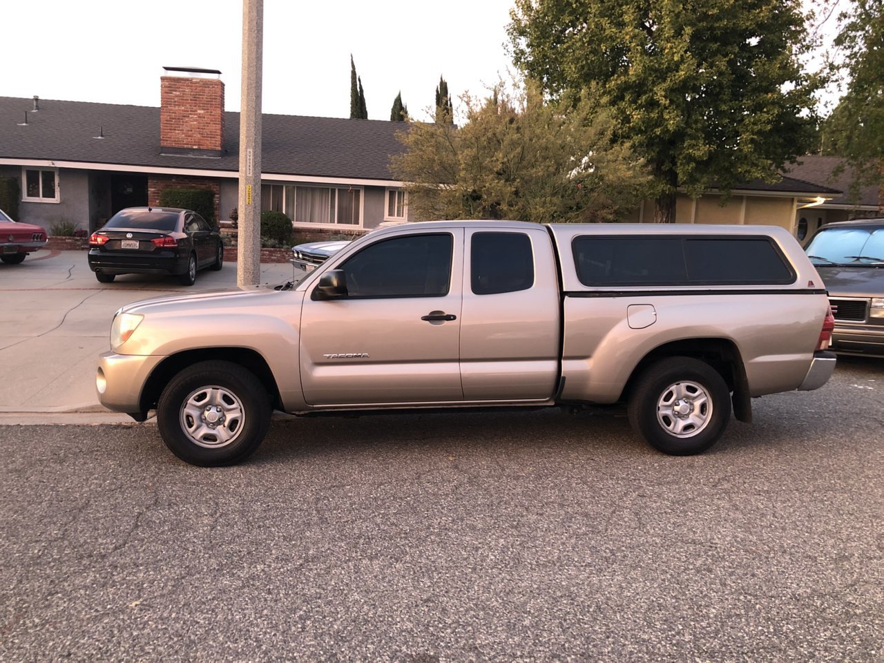

    What Shocks for 2006 Tacoma 2WD 4 Cylinder for Best Ride?
    I've been servicing my recently purchased 2006 Tacoma 2WD 4 Cylinder. It has 105k miles with the original shocks. I don't want too stiff of a ride since I don't take it off the highway much. What shocks will give me the most comfortable ride.
    As always, thanks TacomaWorld peeps...
