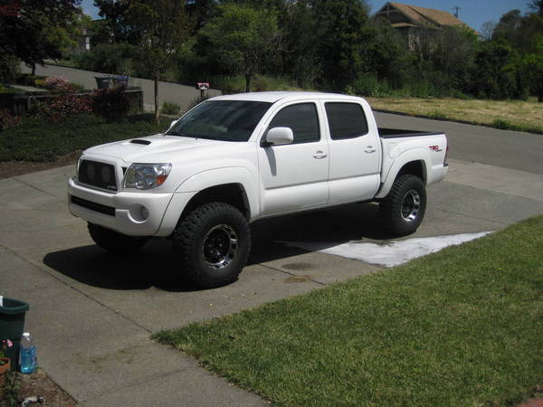

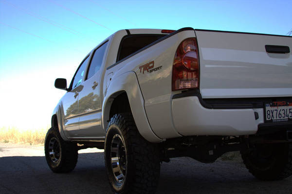

  15. Nov 7, 2011 at 6:12 PM
    cummins6speed
    cummins6speed Well-Known Member
    Jan 9, 2009
    #12426
    1,817
    '05 4Runner Limited Edition
    Custom extended travel 2.5" King RR coilovers, 1.25" Camburg uniball uppers, homebuilt tube bumper
    My girlfriends truck has camburg spindles and a used J66 pack in the rear and it sits almost perfectly level

  17. Nov 7, 2011 at 6:22 PM
    #17
    cummins6speed
    Jan 9, 2009
    #12426
    1,817
    Way. Ill see if I can find a picture of it. Im sure she has some on here somewhere
  18. Nov 7, 2011 at 6:26 PM
    #18
    cummins6speed
    Jan 9, 2009
    #12426
    1,817
    Camburg spindles. Stock C/O's. Deaver J66 pack that she bought used
  19. Nov 7, 2011 at 6:32 PM
    #19
    PLC721
    PLC721 Well-Known Member
    Dec 27, 2009
    #28268
    19,151
    Patrick
    Chandler, Az
    2017 Toyota Tundra Crewmax ProKiller
    Kings, Camburgs, Methods, Vision X, BFG
    Hmm well my buddies were beat on daily so maybe that's why?
  20. Nov 7, 2011 at 6:35 PM
    #20
    cummins6speed
    Jan 9, 2009
    #12426
    1,817
    Possible. The guy she bought these off of said these would need to be re-arched but we just put them on and they were perfect
