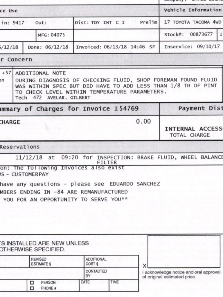

    Update.
    So I called my dealer the next day. Spoke to the service advisor manager and told him the story. He said he would talk to the foreman and update my work log.
    I find it strange that it says it was in spec but he had to add fluid to be able to check the level (I thought that's what there computer was for) I've also read the manual on how to check and change the transmission fluid on this truck and nowhere does it say that you must add fluid before you can check the level. I feel like they added more then they said they did. I'm happy that the truck is driving better but upset that I was driving with it low for 10k miles. I spoke with corporate about it and as far as they are concerned it was fine from the beginning.

    The computer can't read transmission fluid level; it only indicates if the fluid temperature is in the correct range for checking level (since the fluid expands a lot when warmed up). To set the fluid level, there's a check plug situated higher in the pan than the drain plug. You basically have to overfill, run the engine until the fluid is at operating temp range, then open the check plug (with the engine running) until the fluid coming out slows to a trickle.

    Because operating temp is a specific temperature range. "COLD" is not... what if you're checking it in 30 degree weather vs 50 degree weather vs 90 weather... those are vastly different "cold temps". By measuring it at operating temp you're standardizing the procedure. Believe it or not those Toyota engineers are pretty smart ;)
    1/8th of a pint is 1/16th of a quart. Your transmission has 13 qts.... it was off by literally 0.4% thats within the margin of error for even measuring it so your transmission wasn't even off lol. Thats why its still within spec the measurement process isn't that accurate because it doesn't need to be, its not an ultra precise radiological medical device its a transmission and its not going to know the difference between 12.93 quarts or 13.07 quarts.

    If it’s not in writing, it never happened. Get service department to annotate oil was added to transmission
