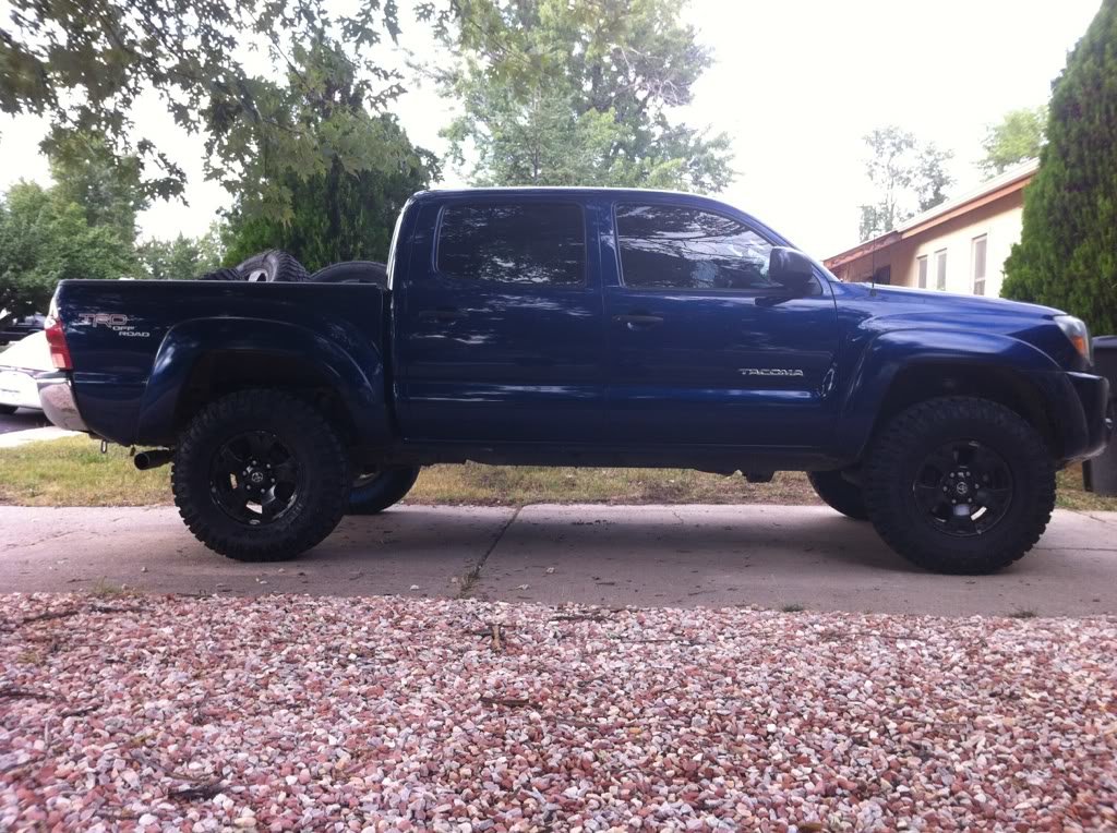

    I have the 2" toytec aal installed with a 3" spacer up front. stock uca's and toytec said I wouldnt need new ones unless I go higher than 3"
    Im sure it added a true 3" of front. If not, then just shy of 3"

    Nice pic Trdbandit, truck looks good. Thank you.
