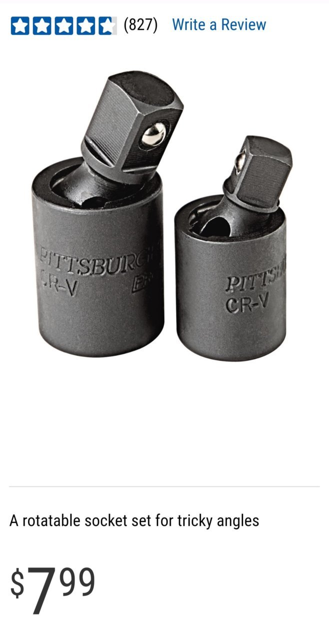

    This universal adapter makes the job a lot easier. I have a snap on and a matco version. But any brand should do.
