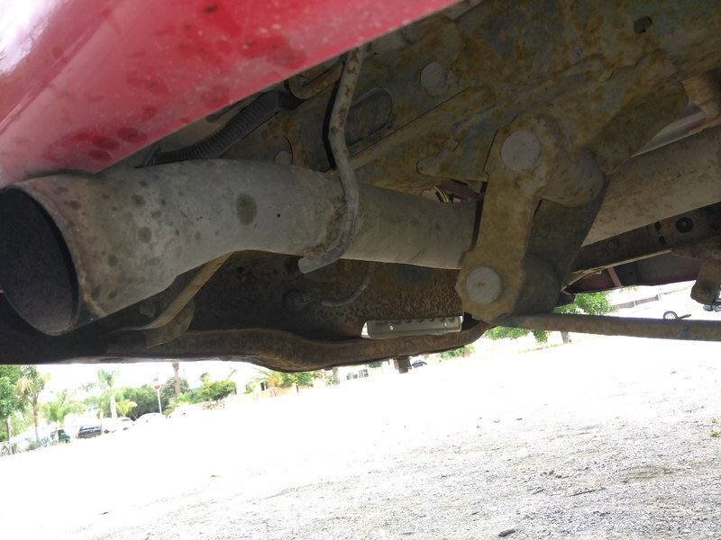

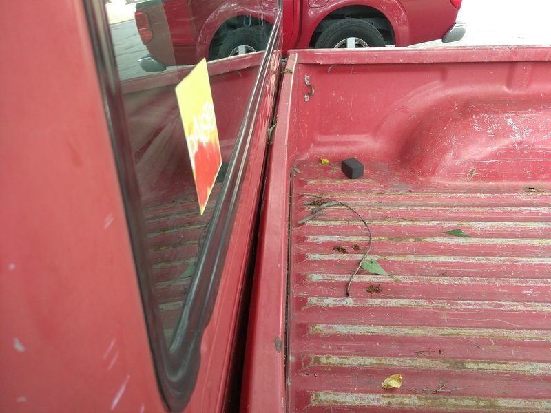

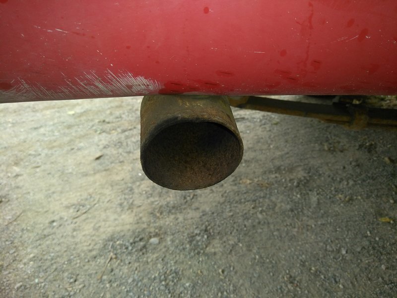

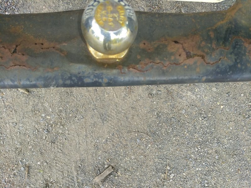

    Hi I've gotten help from you guys on how to get CA plates, and fixing my truck in the past. I recently spent a bunch of money and got the major damage repaired. I'd like to start tackling the smaller things now, but I'm not a truck expert, and might not know what's practical or important.
    Some Rusting through on the bed and rear bumper.

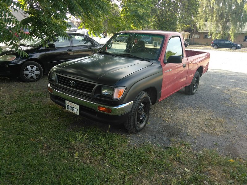

    This fender looks rusty too. Wonder if I should just spray paint it black?
    Doors seem expensive, but maybe I could do something with these?

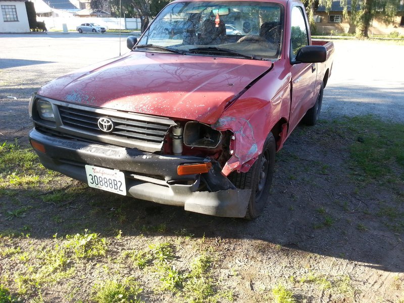

    More minor damage.
    IMG_20170507_095511.jpg IMG_20170507_095703.jpg IMG_20170507_095723.jpg IMG_20170507_095810.jpg

    All mechanics start somewhere. Just start fixing what's already broken, or start doing preventative maintenance.
    If your bumper looks like that I would really look at your frame for rust. If the truck came from a state where the roads are salted your frame could be the same state as that bumper.

    If you're in Northern California and you need some doors, I have some shells from a '98. They're already primed on the outside, original color is red.

    Get to work on that fender! Sand it down until the rust is almost gone unless you have a power sander or a grinder with a soft wire wheel. In that case get it down to bare metal which you should do regardless, ideally. Spray it with some epoxy primer or at least some rusty metal (red oxide) primer and some flat paint. This isn't to just make it look better, but to halt the rust so you can just sand it down once more when it's time to paint it. Before you paint the truck a final time, all the new body panels should be sprayed on both sides with epoxy primer to keep moisture away from the metal.
    Also you can find the weather stripping for the door onparts dealer websites like camelback Toyota or partznet.com. I gotta replace mine too!

    About the fender and rust in general, you should not paint directly over rust. Use a rust converter, put some primer then paint over it.
    If you paint over the rust, it will just come back and make the paint blister and peel off
    Also, your frame, it looks rusty, so if it's not rotten and rusted through, have it greased when you will be done with your repairs. Or you can apply some fluid film to it
