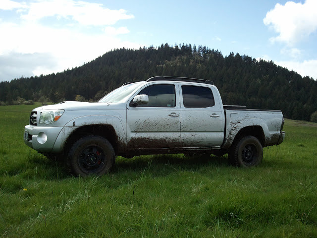

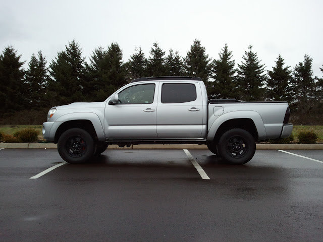

    I don't have the Eibachs, but my 5100s w/ stock coils at 1.75 with a 1.5" 3 leaf progressive AAL from Wheelers gives a fairly close to stock rake IMO.

    tencrawler & Oswego - thanks for the pics.
    tencrawler - did you have the rear TSB done?

    You could do what Oswego did and keep the overload leaf in for an extra 1/2". The 3-leaf AAL is a slightly more involved installation though, you have to cut off the stock leaf pack wraps and grind off the rivits.

    Sorry for the slow response. I do not have the TSB complete. Next lift will be OME or Eibachs over 5100s, UCAs, and A Whole new rear leaf pack. I'm very happy with the handling and ride that the 5100s and AAL gave me.
