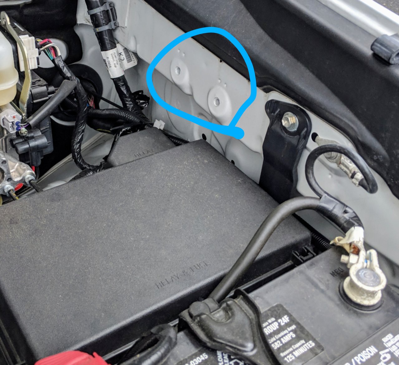

    Anyone know what size these 2 holes are?

    They’re metric with a really weird pitch. That’s about all I got

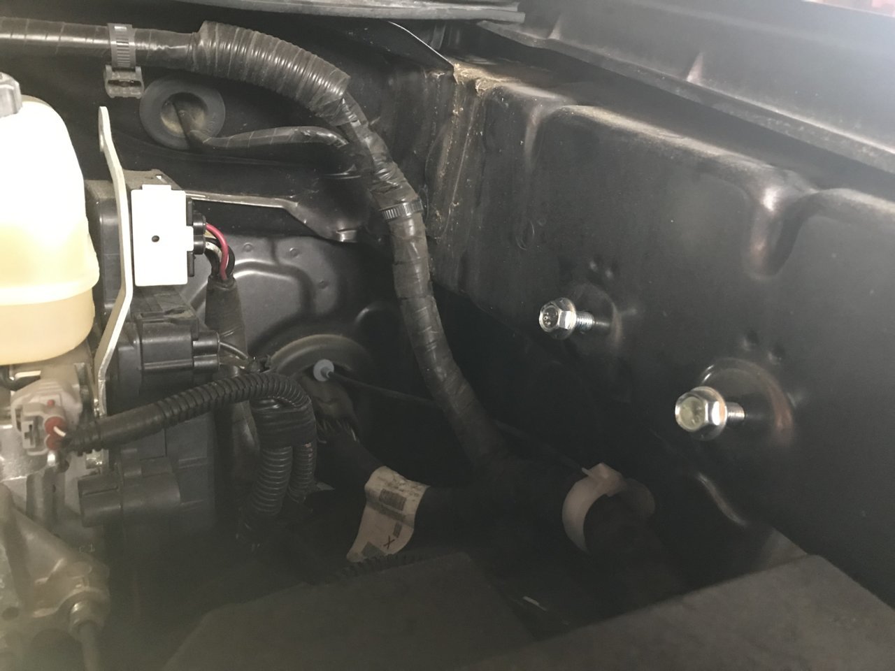

    I don’t think it’s uncommon if that’s what you mean. I just bought some longer ones at Ace for exactly this location.

    M10 x 1.25. IIRC. Standard pitch, same as in 2nd gen.

    The bolt on the rear of the air box mount (12mm socket) fits the hole and I measured the pitch to 1.25 so I think you're right. "M10 1.25" Thanks

    Those look to be 6mm, just like the bolt to the right fastening the black fuse box bracket.

    A bolt with a 12mm head is prolly an 8mm.

    M8 x 1.25 confirmed for 2nd Gen.
