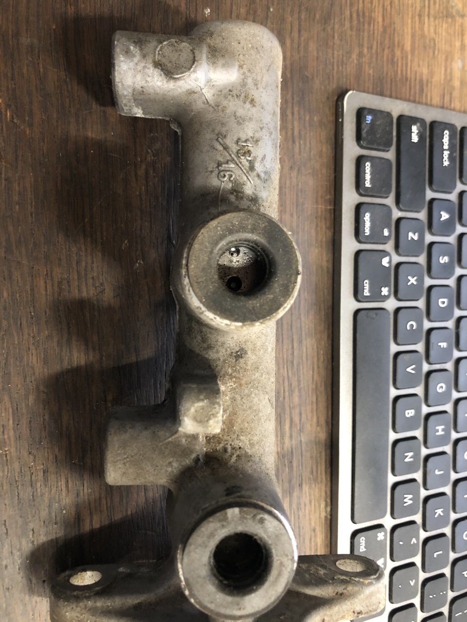

    Like the title states I'm curious what brake master cylinders were used in first gen tacoma's. I always see it stated online that they came with 1" bore from the factory but I've owned my truck since new and it had a 13/16 MC. Rockauto is also showing a 13/16 MC for both a 2003 tacoma and a 2003 tundra.
    It should be stamped on all oem and most aftermarket master cylinders

    7/8 or 13/16

    I just looked up a 95 tacoma and it does indeed have a 1" bore master cylinder for both abs and non-abs models. Its looks like the older style 4 bolt mounting flange though.

    Definitly Tacoma. It appears that the 4 bolt 1" master was used in v6 4wd models until around 2001. It also doesn't seem to matter wether you have abs or not. Im curious about what changed to warrant such a smaller master cylinder to be used in the later model trucks

    Brake vac boost upgrade

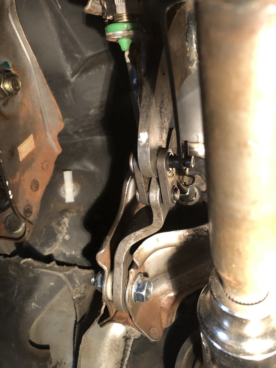

    I wonder if the early tacoma's with the bigger master cylinder still have that funky pedal linkage with the 2nd pivoting arm coming up from the bottom. Maybe that increases the throw of the pedal to make up for less fluid being moved???

    Black Dog was right. The vacuum brake booster went from a 247.14mm diaphragm to a 272.67mm diaphragm the same time the master cylinders changed. But now I'm curious if the 4runner dual diaphragm brake booster has more or less power then the big single diaphragm tacoma brake booster??? Time to find a engineer I guess
