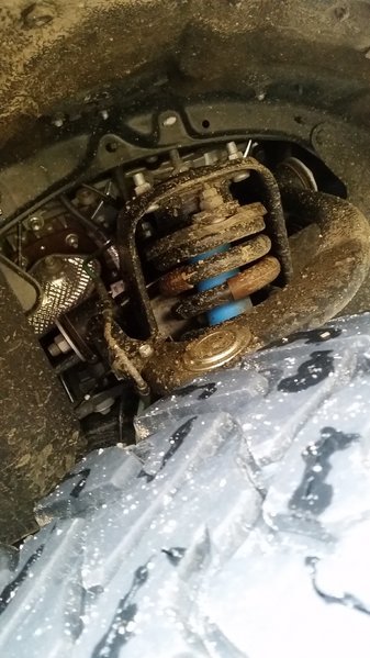

    Any clue what size spacer this is?

    1.5-2" it looks like

    Uhhhhh......2"? :notsure:

    You could measure from the center of your hub to your fender. On stock 2nd gen tacomas that measurement is 20 inches. So if you measure 22 inches, then you have a two-inch lift. I'm sure you can find the stock height for third gens with a quick google search.

    -2 inches?
