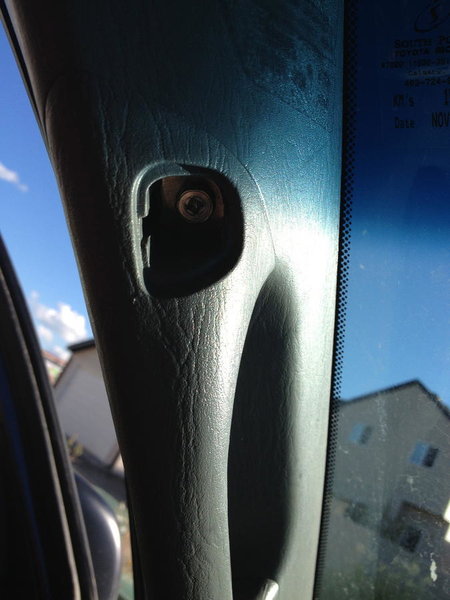

    Hey everyone.
    I was trying to get the handles off on the drivers and passenger side. I had used a star screwdriver to get it out and it was starting to strip. I had to get them previous taken off to get my roof fixed. I didn't want to strip the bolt anymore so I was wondering what size of socket do I need?
    Any help would be great,
    thanks!

    10mm I think

    Get a metric socket set, and put a socket on it until you find one that gives a good purchase.

    yea 10mm

    I would guess 10mm

    FYI all the nuts and bolts are metric, ranging from 5.5mm (blower motor bolts) to 26mm (alignment cam nut). Most of the more common sizes you'll use are 8mm, 10mm, 12mm, 14mm, 15mm, 17mm, 19mm, 21mm

    That would be a Phillips / Hex Head.
    Please for gods sake don't call it a star screwdriver. :rolleyes: It sounds retarded! ( Just trying to help you out ).
    It is as bad as Doohickie and Thingamabob like my wife calls things. You aren't a chick are you? :D
    And by the way the bolt is a 10mm as others have said.
