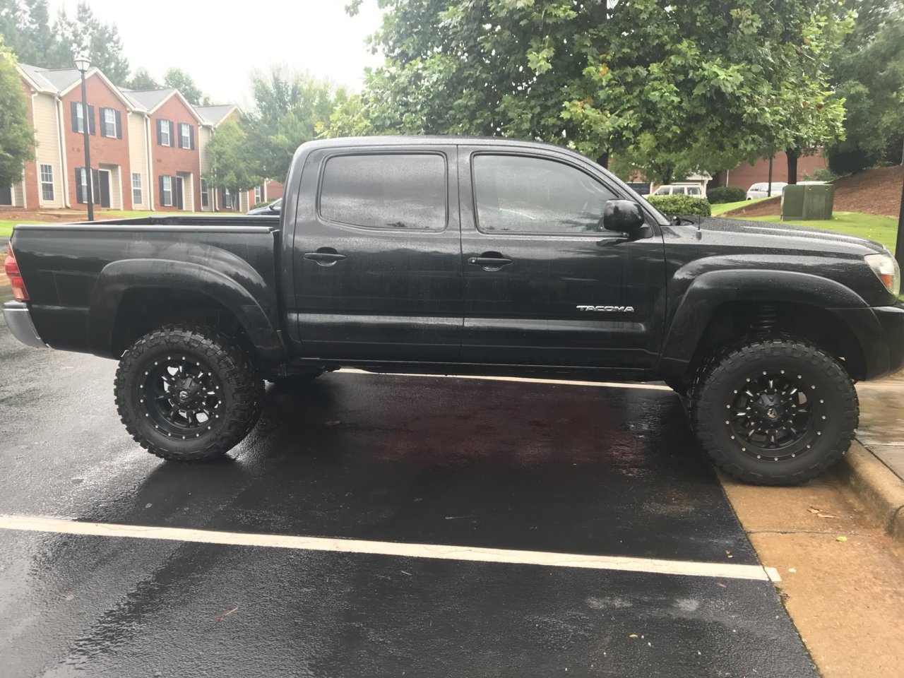

    Yep! That seems to be everything. Like I said, you should be good to set the bilsteins to the +1 inch notch (#3), but depending on your wheel and tire setup you may need to do the 1.5 (#4) but I really doubt it.
    here is the ride height you’ll be sitting at just about.
