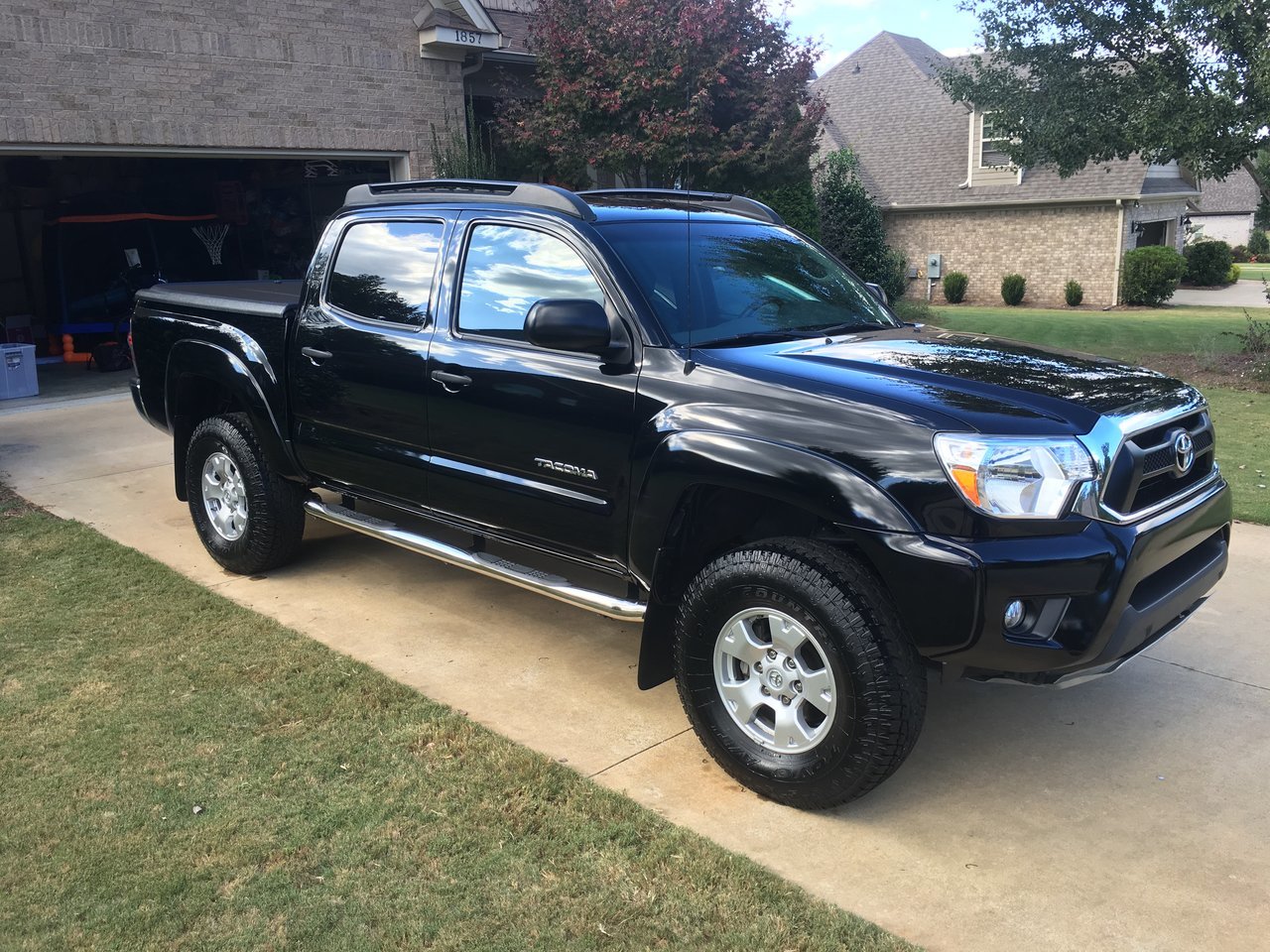

    2.5 level in front 1 in back with 265 AT tires
    TacoTruckChuck[OP] and 757yotas like this.

    Looks great

    Wow your 1” in the back was enough to make it level? Or did you want the front to be higher?

    So no rubbing on the frame when you turn the wheel to lock and back up out of a driveway? If it doesn't rub, what offset are you running and what are your alignment specs?
