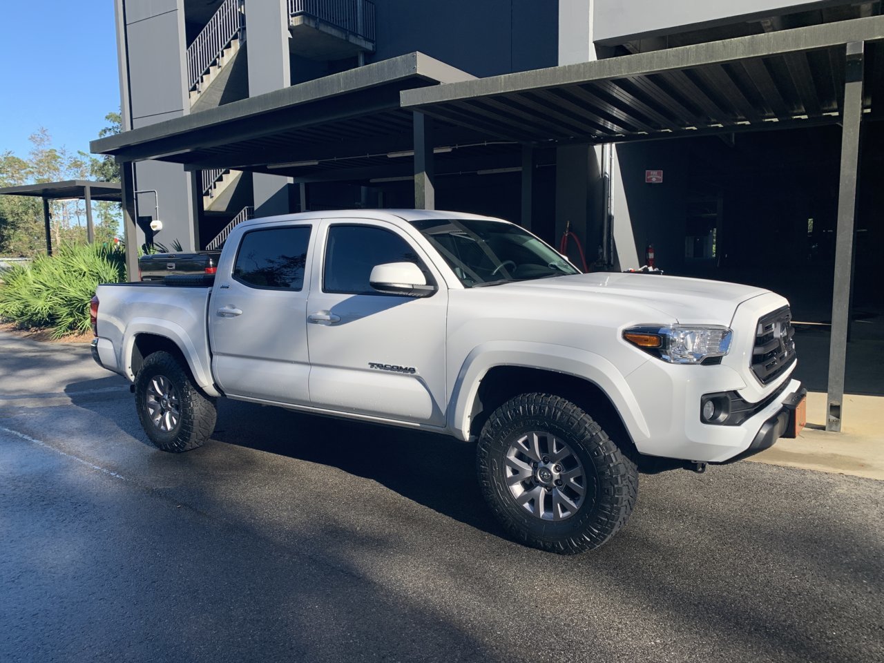

    265/75/16 Ridge grapplers on stock suspension. No rubbing what so ever.
