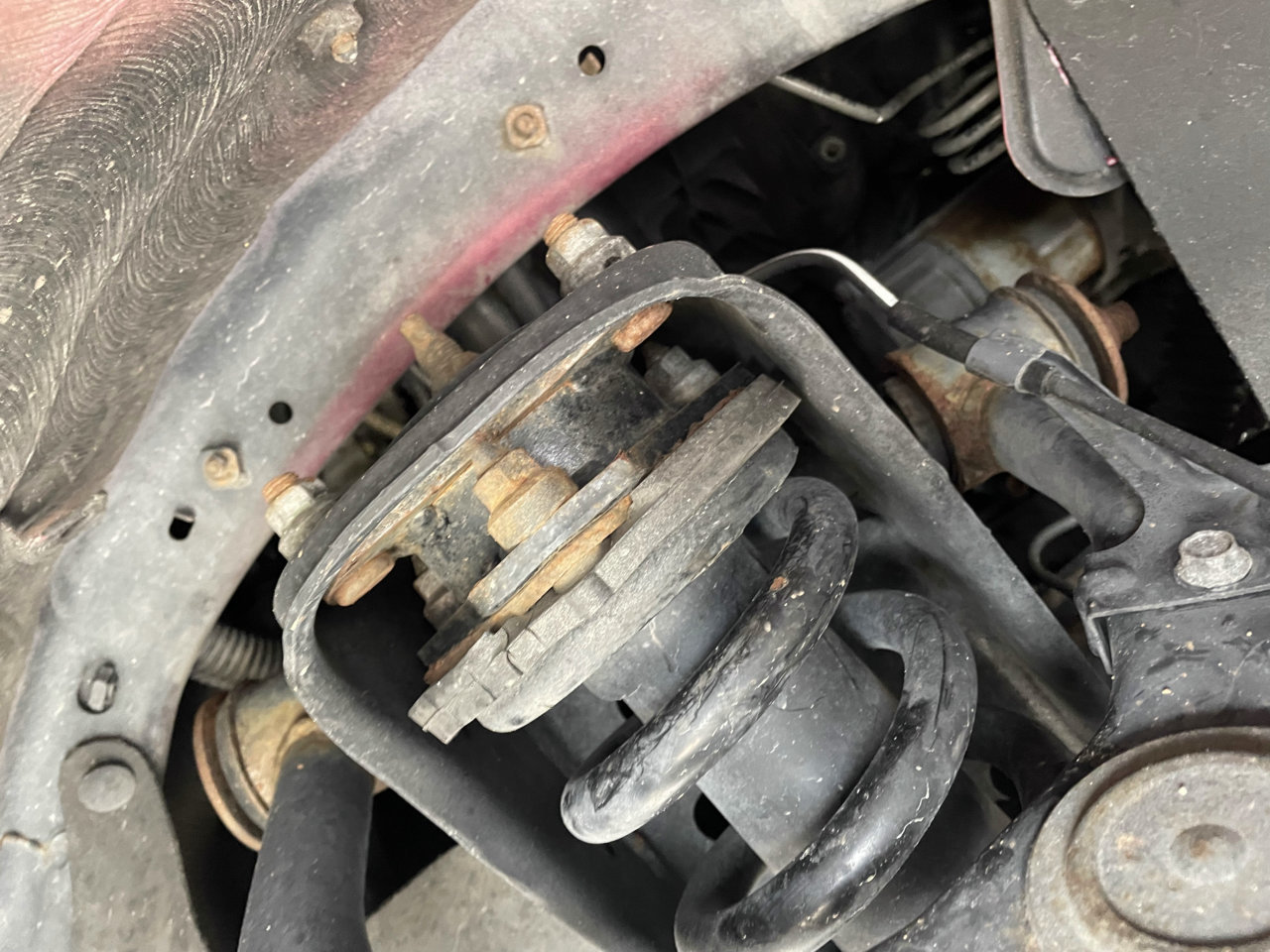

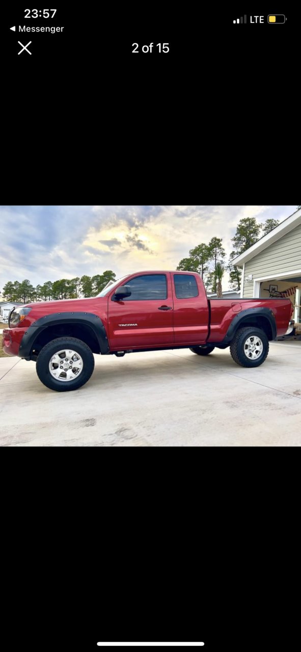

    Any wheel and tire suggestions?
    Just got my tacoma 2 days ago!

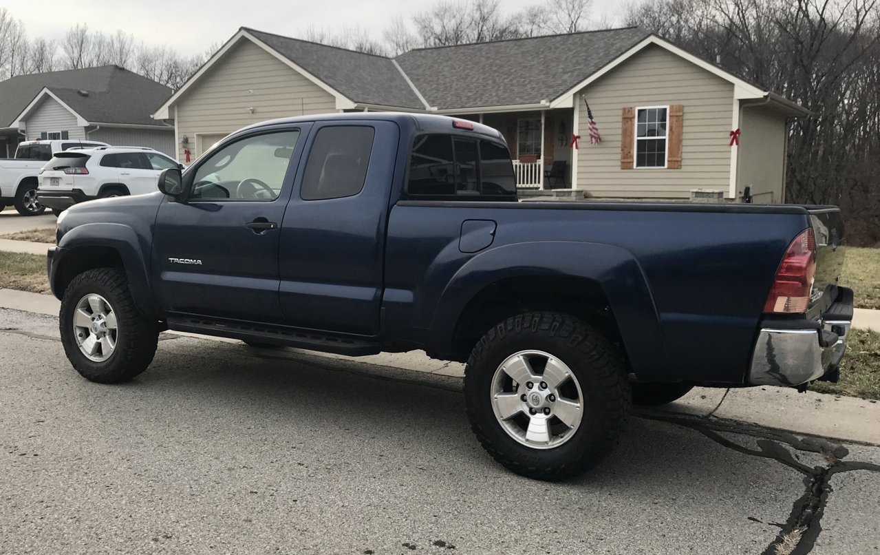

    new 17" tacoma wheels with 265/70/17 meats, stock for now
    I have Cooper discoverer rugged trek 265/70/17 with bilstein 5100/OME884 in front for 1 3/4” and 5100’s with icon progressive aal in back for 1”. No rubbing at all, no vibes, aligned perfectly. 6E0B5846-D39C-4E11-85BE-CA68D5B1FCE7.jpg

    Masters33 what kind of lift do you have on it?
  5. Dec 11, 2022 at 6:02 PM
    Masters33
    Masters33 [OP] New Member
    Dec 7, 2022
    #412494
    4
    None yet searching!!!

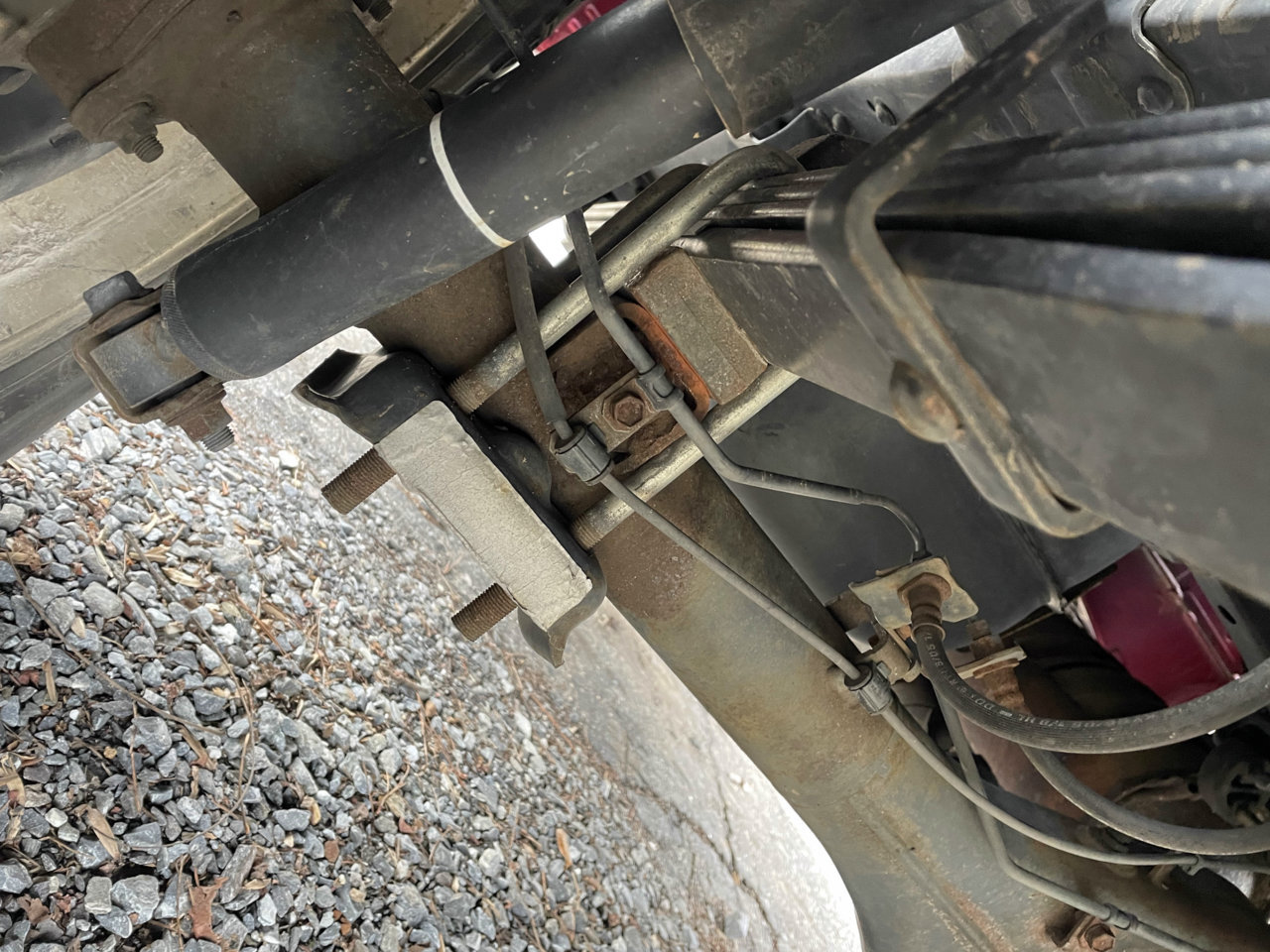

    1 3/4" front, 1" rear block lift
  6. Dec 11, 2022 at 6:07 PM
    Squirrel1969
    Squirrel1969 Well-Known Member
    Nov 1, 2022
    #409525
    76
    2006 Tacoma v6 at 4wd
    Looks more lifted than mine. but I just noticed your on the 16” and I’m guessing 245/75 (or whatever the stock size is), and no steps (I need to take mine off, yuck!) If your not looking to lift more, 265/70/17 on some badass wheels would set the riveted flares off!
