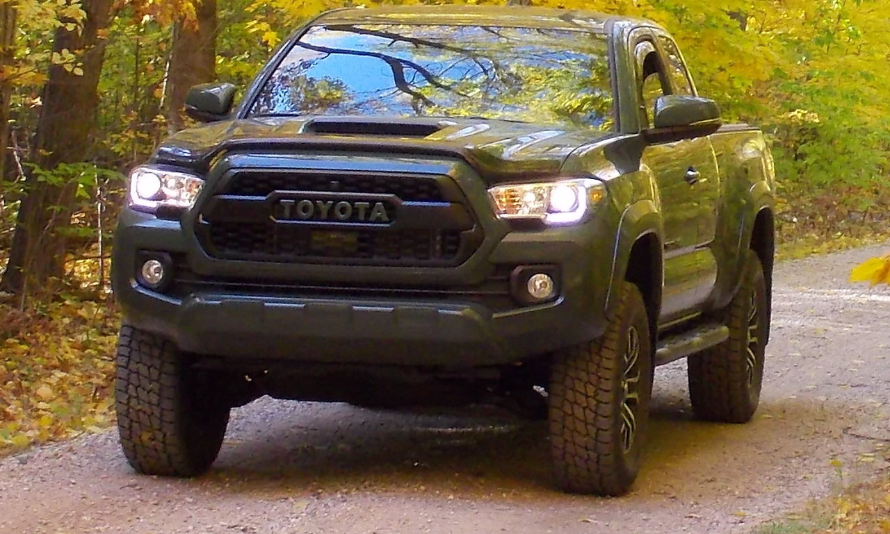

    Irons
    Irons Outlaw Prospector
    Apr 30, 2022
    #396206
    1,130
    NW Michigan USA
    '22 TRD Sport AC MT Army Green
    TRD lift, Exhaust & CAI
    Welcome aboard, beautiful Taco you got there! . :thumbsup:
    265/70r17 is the max size I kept hearing when I was asking the same question, so that's what I had the dealer install.
    And I think they look great on the sport's stock rims.
    TacoTime55 and turkeyslayer66 like this.

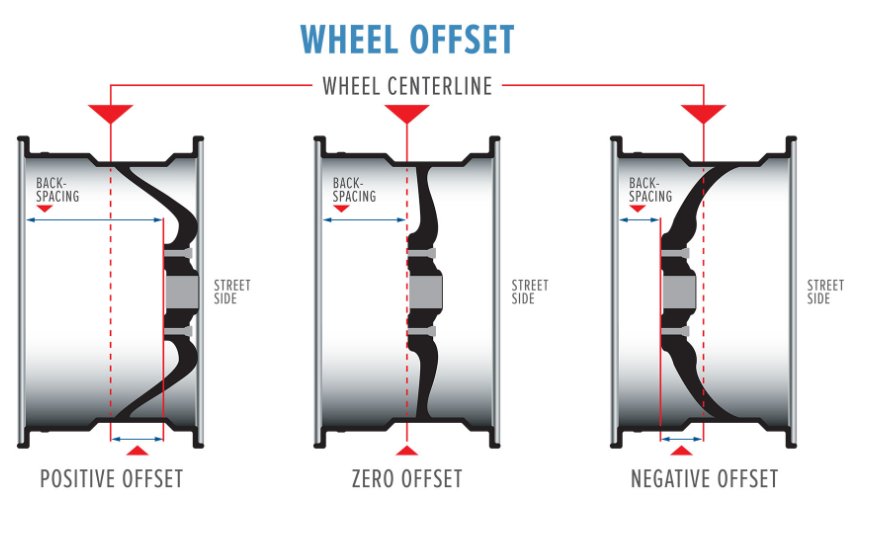

    Mrcooperou812
    Mrcooperou812 Well-Known Member
    Nov 26, 2023
    #438257
    403
    Las Vegas NV
    2016 DCSB OR 4WD
    Nice looking rig man.
    Do you know the wheel size it came with? Toyota dealerships sometimes swap stock wheels.
    Wheel diameter and width dictate what tire sizes can mount on it based on tire manufacturer specs.
    The wheel offset/backspace goes to how much the wheel center point is inside or outside of dead center.
