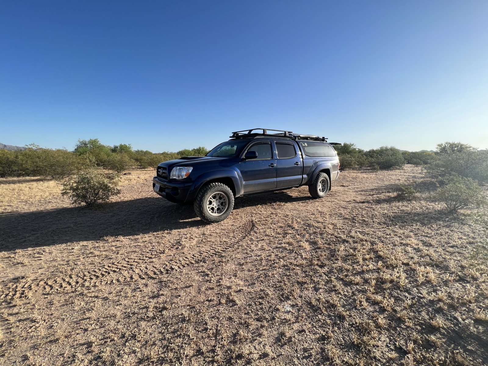

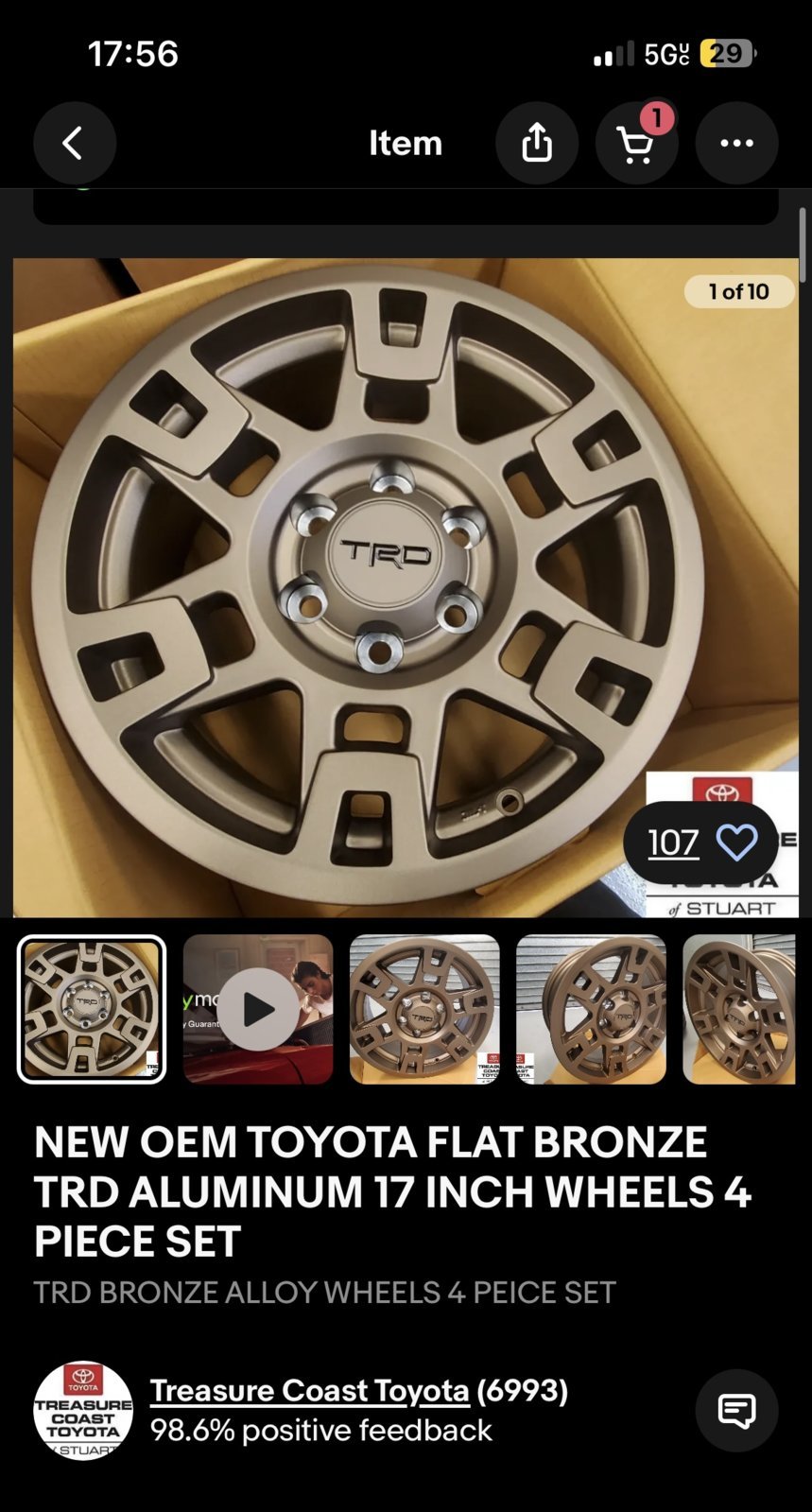

    Hello I just ordered new wheels (17 x7 with a 4mm offset) for my tacoma and I’m not sure how big of a size I could go. I would like to get some KO2’s. Pic has the old wheel and tire on and other pic is the new wheels. Any help would be great. The old wheel was 17 x 8.5 and the tire was 265 70 17. I want as big of a tire as possible thanks.

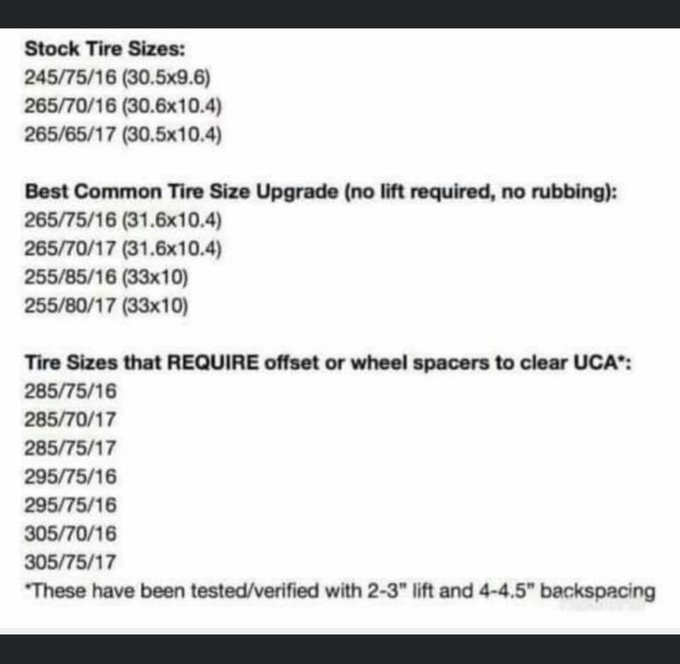

    there is a lot of info if you search but seems a 255/80r17 might fit with minimal trimming. Which is a 33” tire.
    If you don’t want to trim I would stick to a 32” tire. A 285/70r17 pry will need trimming although it’s only a 32.7” tire because of its width.
    But it seems to vary with truck.

    slight trimming had to be done to mine to fit the 285/70R17 (17x9 wheel, -4 offset, & 3/2 lift). Speedometer calibrator also needs to be added with a tire that size to account for the tire rotation. With 275s you shouldn't need to do any of that.
