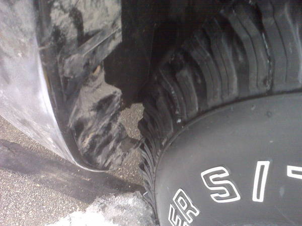

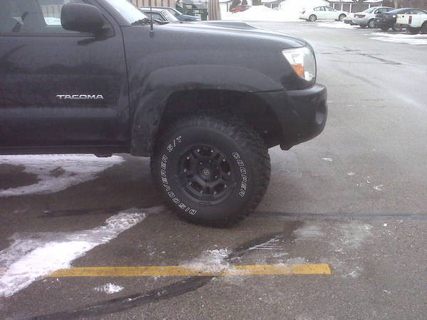

    i put 285/75/16 on mine with an all terrain tread and had to do quit a bit of trimming(plastic and metal) and still have slight rubbing when turning and flexing. i have the 5100s set to the 2.5" lift. a lot of it has to do with rim backspacing

    i put my front to 1.75 and 265/75r16 tires.
