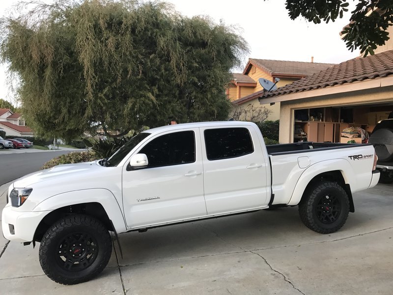

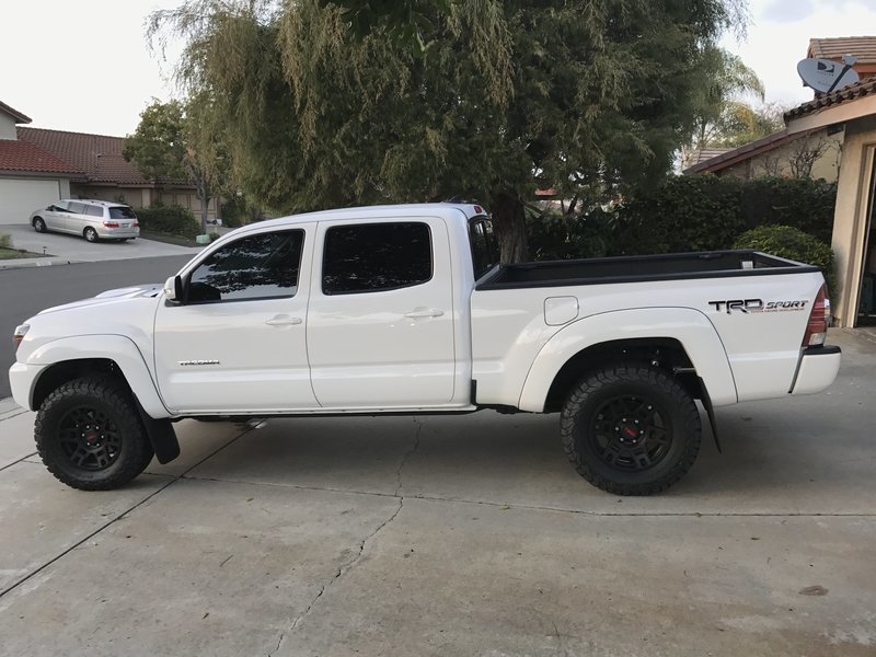

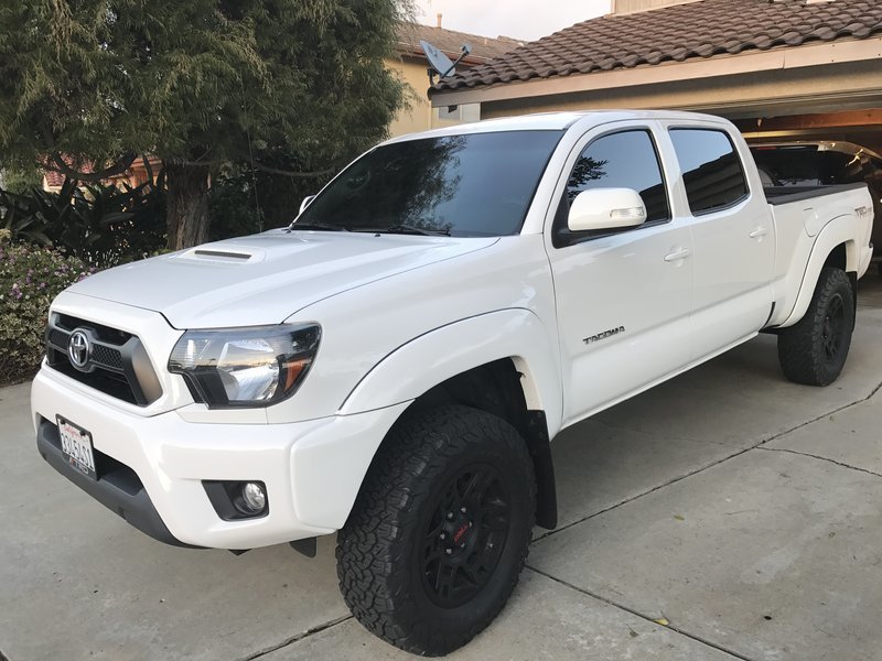

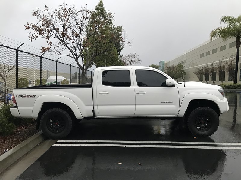

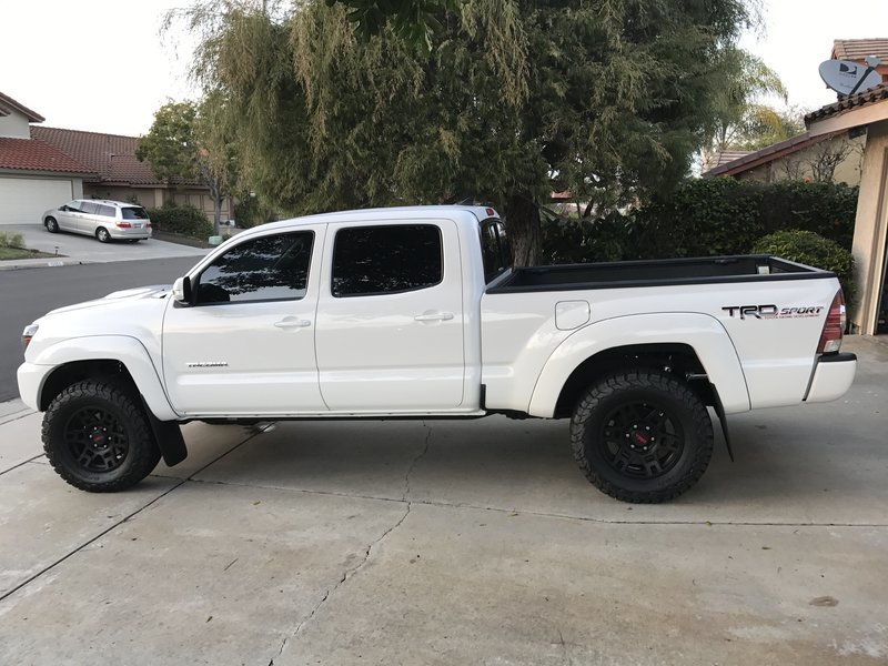

    I'm running 265/70/17 with a 2" lift in the front. I've had the lift for a little over a week and the tires for a little over two weeks. Strangely, the only time I've noticed rubbing was after the lift and when at full lock in reverse. It was very minor and only on the small micro mudflap in front of the tires. It only happened once and wasn't a bit deal at all. To answer your question, I'd recommend 265/70/17. Here's some pics for reference.

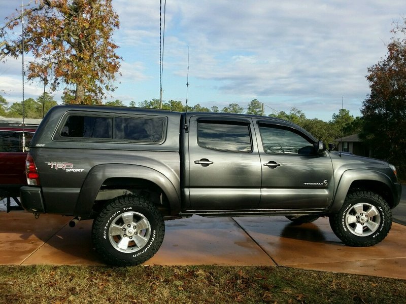

    I just installed BFG 275X70X17, I have 5100's all around with OME leaf pack, front is set on 1.75 and I have yet to rub from my knowledge, since I have moved to FL I have no idea where any hills are to go off road, I don't think hills exist here LOL ;)
