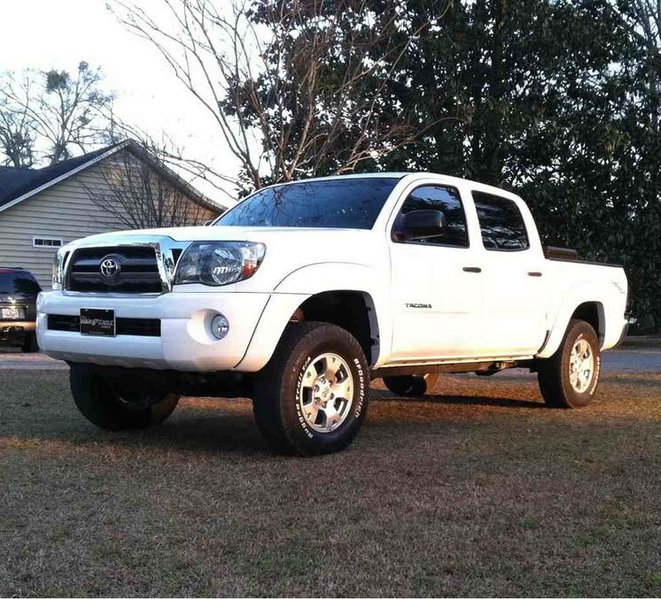

    Any suggestions on the largest tire size for a 16 in rim with a 2.5 leveling kitImageUploadedByTapatalk1360193434.420316.jpg
  8. Feb 6, 2013 at 3:38 PM
    Oowen
    Oowen Well-Known Member
    Nov 2, 2011
    #66326
    1,371
    Owen
    Reno, NV
    '22 Cummins
    265/75/16
