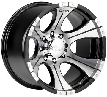

    Hey guys. Im putting my new 265/75/16 tires on today and have the 16x8 stell facotry wheels. Im want these dick cepek ones. they look nice and cheap. what size and back spacing do i need. I know i need 16x8. would it be 5-5 bolt circle 4 back spacing and -12 offset. I just had no idea and would i need wheel spacers or no. I suck at this but i know ill need new tpms. thanks i have 2010 dc

    You will want 6 on 5.5 bolt pattern, and if yopu only want to fit 265's, you can get anywhere from 4.5" to 5.5" backspacing.
    You will not need new TPMS. The wheel shop will either flip the sensors 180 degrees, or they can use TPMS straps to hold them in place.

    Ok thanks so just to make sure here is the page of the sizes.
    can you pick out the one i need. Just paste the part number on here. thanks I just see no 6.
    Here is the link
    http://www.dickcepek.com/wheels.php?item=DC2Black

    1168412** This ones has the right bolt pattern and 4" of backspacing. They will stick out 2.5" more than your stockers. (1" from the width, and 1.5" from the backspacing.)
    Some have reporting more rubbing at 4" backspacing than 4.5", but it doesn't appear the DC-2's come in 4.5" BS for a 16x8.

    Ok thanks guys so much. So do you think putting these wheels on my new 265/75/16 will rub the front wheel well if i get them.

    I like these wheels alot. I just wanna make sure that they will fit the new tires and be ok and not rub alot lol. You guys are the best.

    I doubt it would rub anything except maybe the front mudflaps if you are unlucky.

    you two are both the best lol. And thanks again. I took my front mud flaps off so I should be good and they not rub
