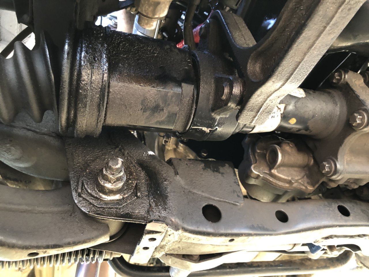

    There's a small problem. There seems to be a small oil leak on the passenger side of the engine. I really don't have any idea where it's coming from.
    When I say small, I mean there are a few drops in the ground this morning after being parked all night.
    Any tips on determining where its coming from?
    CS_AR likes this.

    Can you determine if the leak is at the front or rear of the engine on the passenger side?

    It's neither front nor back really, I'm seeing the drops form on the axle. I'm wondering, is this even engine oil I'm looking at?
    The axle was dirty and oily already, which was somewhat from the rod punching through probably, but now I'm wondering if there is something else leaking. What else could this be? I feel like I've felt around all over the block and I'm just not feeling any oil at all.
    If you look at the photo above you can see the drop formed about 5" to the right of the rubber boot.

    Damn it. I googled "Tacoma leaking front axle" and I see a bunch of pictures that look like mine. What does the diff lube look like? Just like clean motor oil? Because that's what I'm finding on the garage floor.

    I'm not sure what 4WDs use since I only have a 2WD. But I do use Redline MT90 in my manual transmissions and it is almost clear.
    Its noticeably thicker than motor oil to the touch.
    Does the lube feel like its thicker than motor oil?
    It looks like a leak may have been going on for a while.
