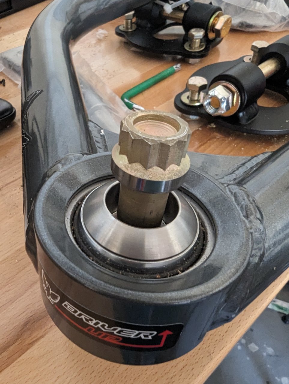

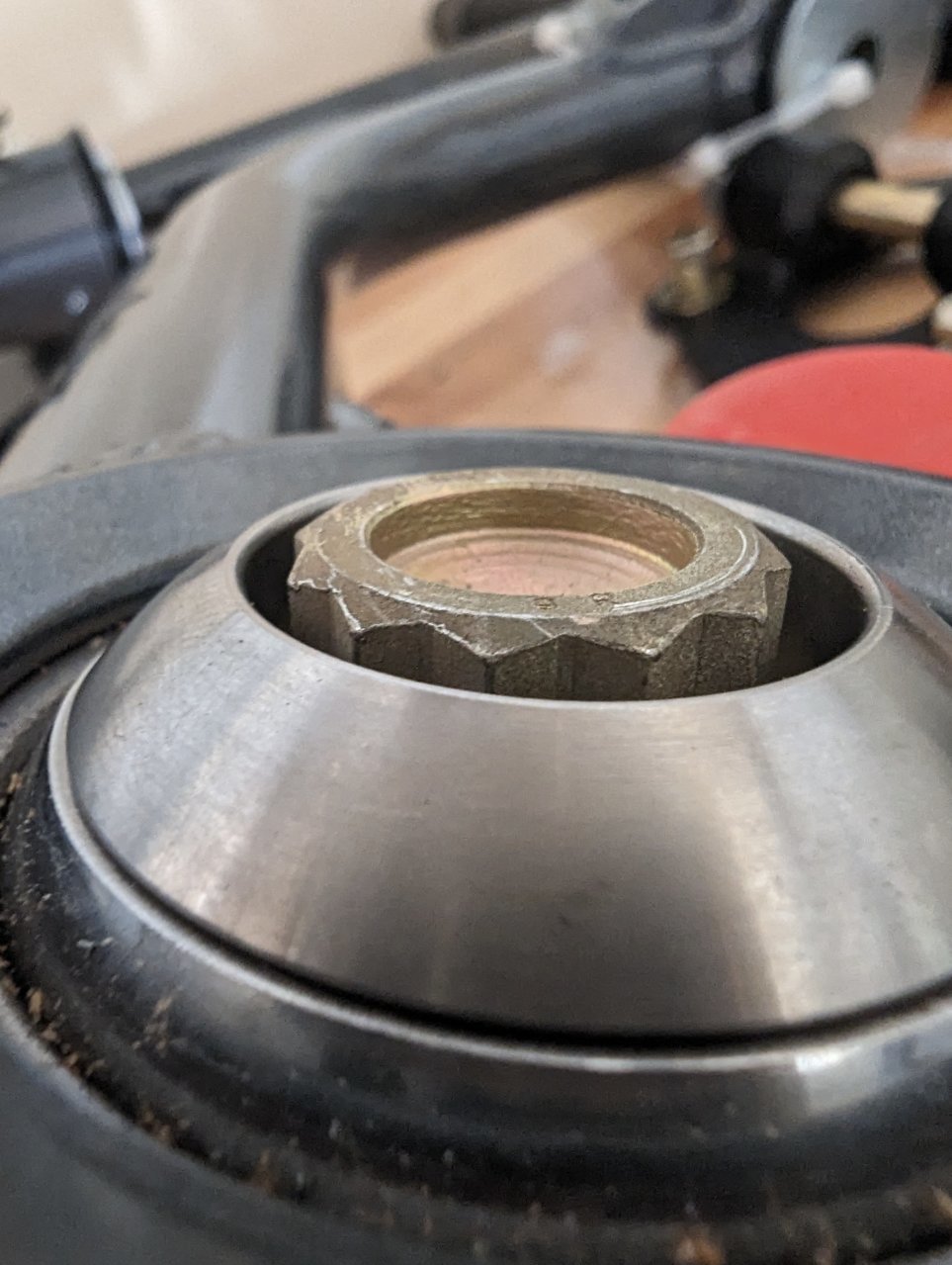

    The walls of my sockets are all too thick.

    You’ll need a thin wall socket

    I know snap on makes 12 point thin wall sockets, I am sure other cheaper brands aldo sell them. Maybe the camburg website lists a known socket that will fit or theres a youtube video that tells you one that fits.

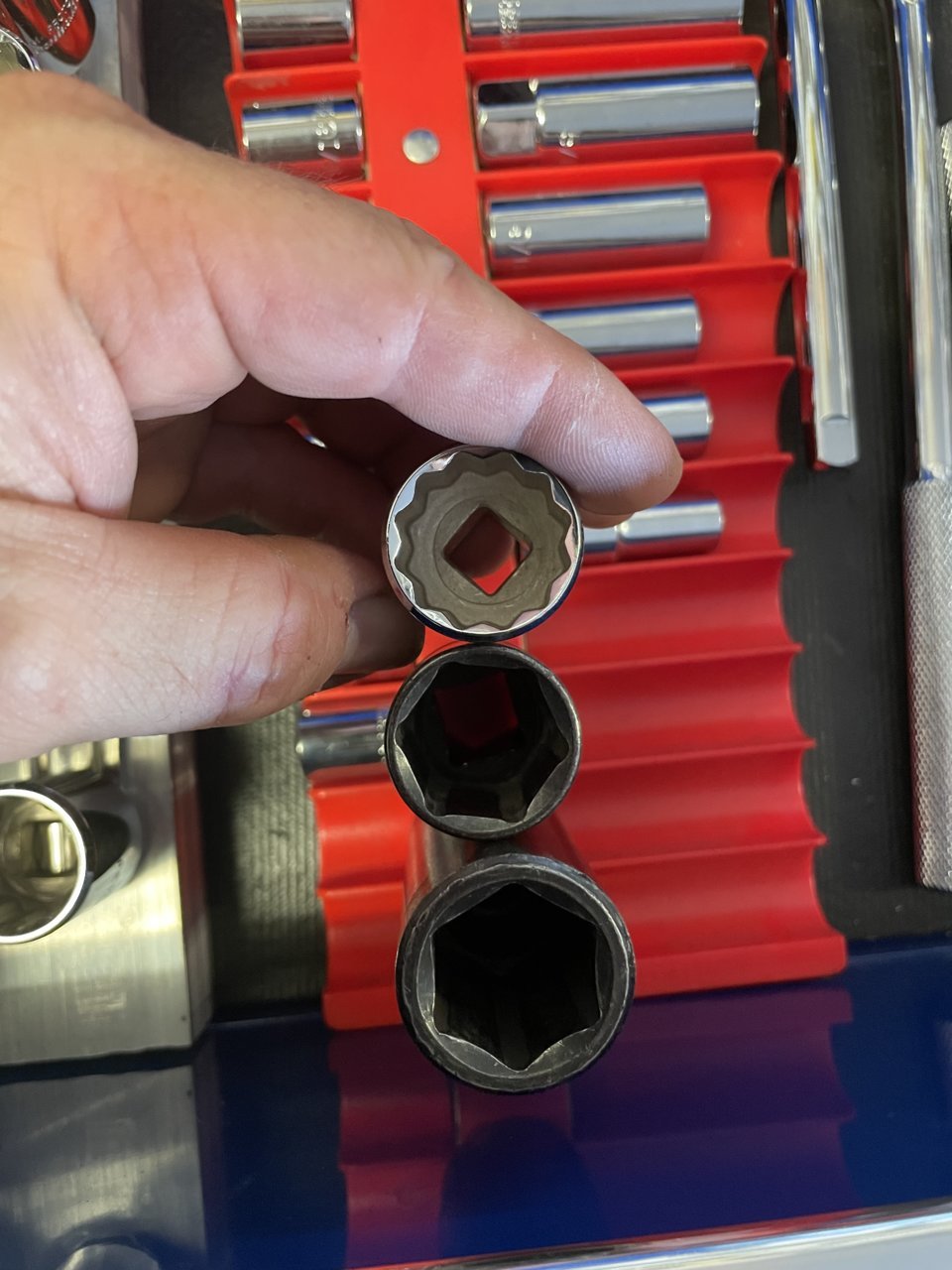

    You using chrome or impact socket?

    Either is fine for me.

    Thin wall generally relates to impact grade sockets. Chrome is already as thin or thinner than impact grade thin wall.
    21mm in 12pt chrome, thin wall and standard impact

    I called Camburg. They use Snapon. The socket size is 11/16 so it's not as tight as I originally thought.
    I found a tekton 11/16 12pt impact that looks like it'll work for $9

    12 point, 1/4 drive chrome socket, not impact would be your best bet.
