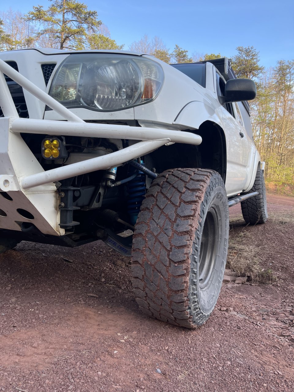

    My specs are 16x8 SCS f5s with - 25mm? 3.5 back spacing. In the rear I've got the same wheels, but with a 1.25 spidertraxs spacer to clear my shocks. Tires are 315 75 16 st maxx

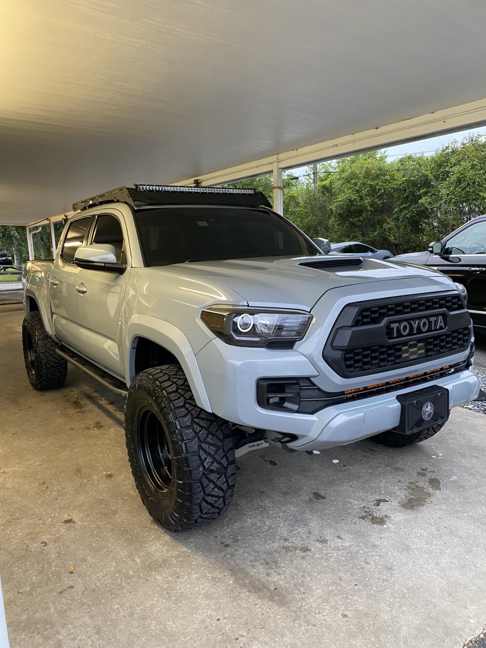

    Had 35x11.5’s on -10 SCS’s and went to a 305/70r17 (34x12.2) on SCS 17x9 -38’s. Wanted the wider stance. Been super happy. Clearance is a little better with the new setup but both cleared no problem around town with Only slight rub when compressed. Work done: aggressive CMC (relocation is next), viper cut, pinch weld smash, slight plastic trimming. Would like to get the fenders cut but I need to find someone to help with that. I don’t trust myself on that one haha

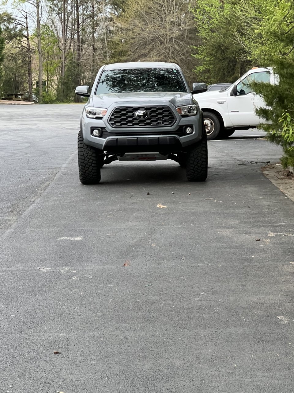

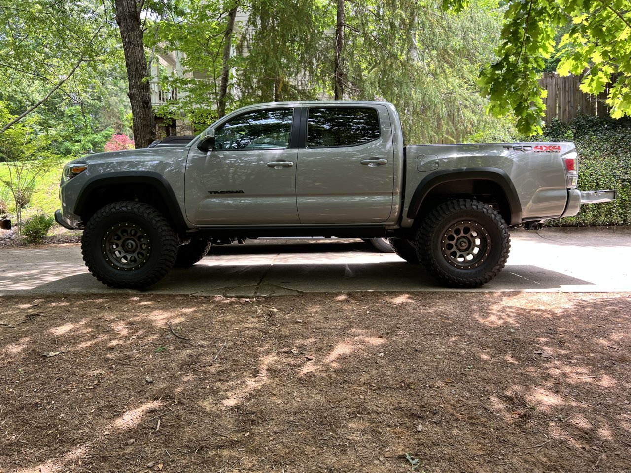

    35x12.5 on 17x 8.5” wheel.
  12. Jun 3, 2022 at 8:59 PM
    #72
    Junkhead
    Junkhead TRDude
    Feb 27, 2019
    #284671
    15,685
    Serge
    Prince George, BC
    Black 4x4 Sport MT 2018
    Some Serious Tires
    Damn, looks mean.
    BTRD[QUOTED] likes this.

    Nice Rig! Are you running the stock UCA's? Your camber looks a bit off? \---/
    Could be the picture angle??

    I have the icon billet UCA. Cambers good it’s the pic.

    How much lift? To me this is perfect proportions.

    Appreciate that, I have almost 3” in the front and a tad over 2” rear. I went completely level for awhile and just couldn’t put anything in the bed without reverse rake. So I settled with close to 1” rake.
