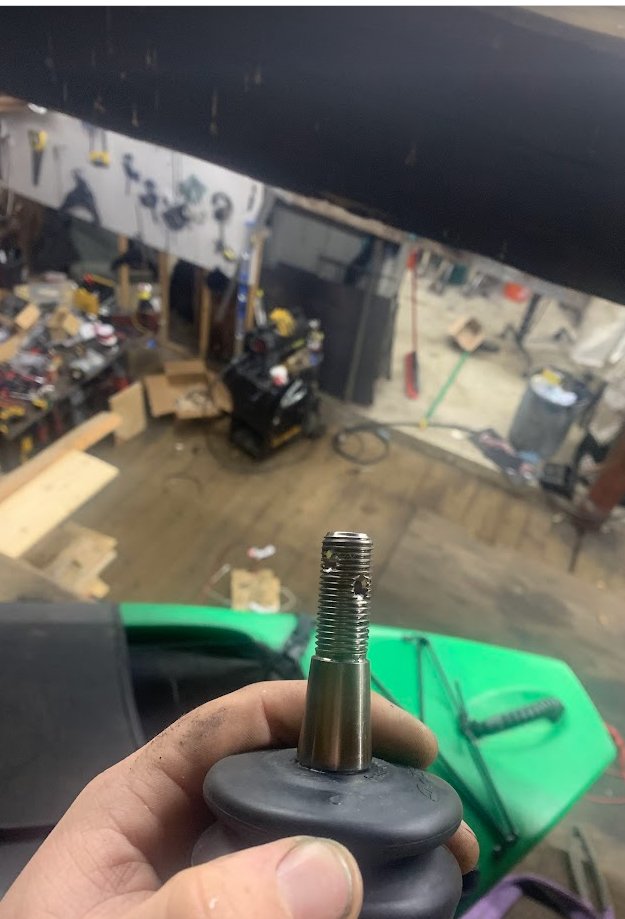

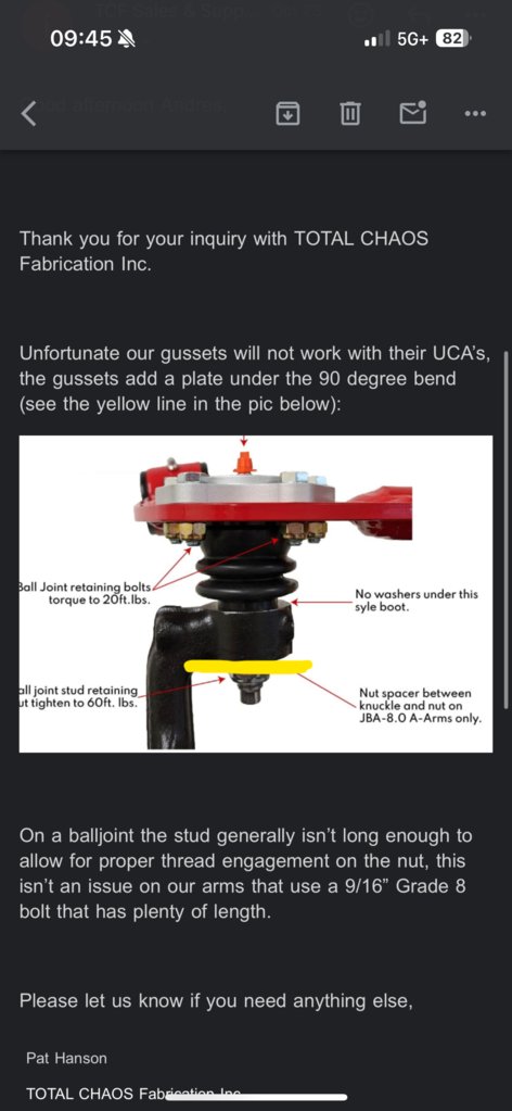

    I’m looking for spindle gussets cause I’ve already bent my spindle and don’t want to go through that pain in the ass again. I’m looking for one that fits JBA Off-road UCAs and keep the sway bar, I already messaged Total Chaos and they said it wouldn’t work with theirs, but I have no confirmation from other companies, does anyone have JBA UCAs that know for a fact which one will work?

    I see JBA already uses a nylok but on the ball joint. Why would any spindle gusset have an issue with the UCA?
    All-Pro spindle gussets have a cutout to accommodate the sway bar.

    No idea, but this is what Total chaos told me and All pro said they can’t guarantee it’ll fit since they’ve never tested JBA UCAs
