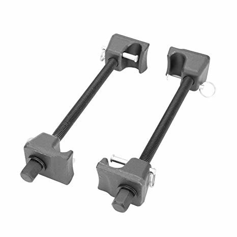

    Need to pull out my COAs and compress the spring a few turns. The rental from Autozone doesn't seem to fit even close. Added picture of my COA and the rental for reference. Wondering what you guys are using to get between the coils. Any and all input is appreciated.

    Where are you located? What is the spring rate? Are you trying to use it while the shock is still on the truck?
    The rental you have pictured does work for factory springs but I wouldn't trust my life with it on any aftermarket/performance application.

    I use 3 of those compressors pictured for my kings. It will mark the powder coat on your coils, and it takes some work to get them in but they do fit.

    located in central FL, 650# spring. Not using while on truck.
    Currently looking at this option strongly.

    If it doesn't have ACME threads I wouldn't recommend

    I second this. The $40 it's going to cost is not worth loosing your teeth or any extremity of your body. If you're not swamping springs often there's no point in spending money on the proper tooling either.
    I use this personally.
    https://www.amazon.com/dp/B00LB61TGQ

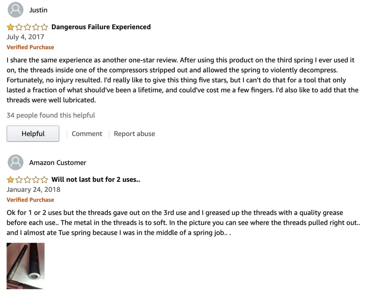

    you guys have a damn good point here. $540 is a tad out of budget range haha. I really only need to offload enough tension to crank them down a little (not removing the spring) so I need something narrow enough to slide in but safety is always priority number one. Had a close call last week doing the ECGS bushing swap so I've already used up one life working on this truck. Thanks for the input fellas.

    you right...
