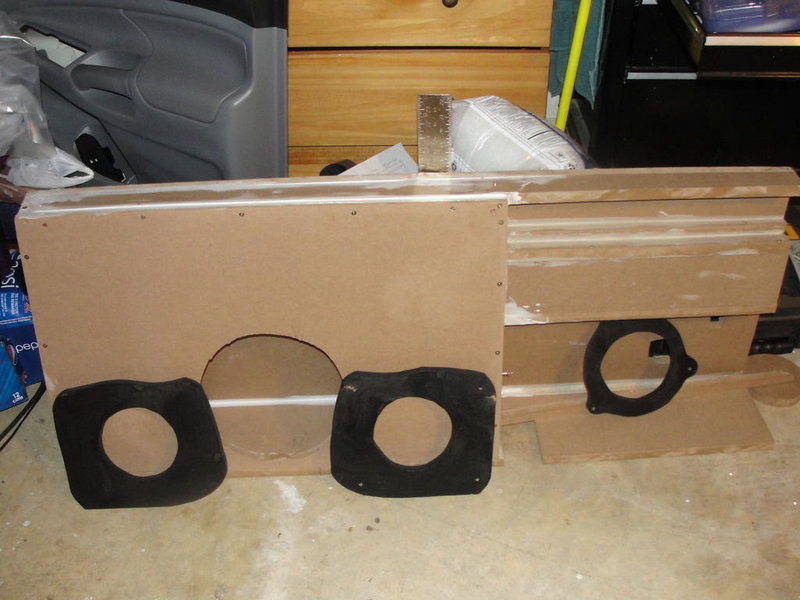

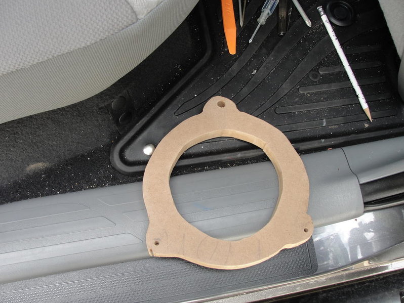

    make your own adapters (1/2" or 3/4" MDF board) then you can fit anything you want in there.Prefer 3/4" adapters , gives you more depth for speaker so it doesn't hit window when down.

    Here are some pics of adapters i made out of 3/4" MDF. The left are the front doors (they are a lot bigger than the rear doors). I bolted them in with small 2" bolts ,washers and knylock nuts. I busted those plastic adapters out of there.

    I don't understand. If the hole only houses 6 1/2's, then how can a thicker adapter help?

    Mounting depth. Thats the only reason some 6x9s dont fit

    Edit: if you get those speakers you need to have at least a 1" thick adapter. ********* claims their 1" 6x9 adapter will work up to 3.25" top mount depth. Those polk audios have a 3 3/16" top mounting depth. So your windows will clear the speaker by 1/16
