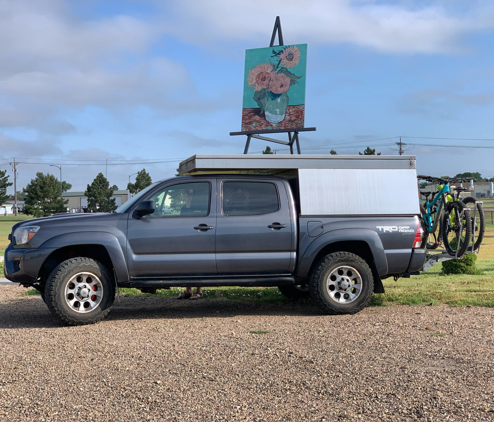

    Pretty much most Toyota 6-lug wheels. That includes other models like the Sequioa, Tundra, 4Runner and Land Cruisers. Even Lexus GX series and others.

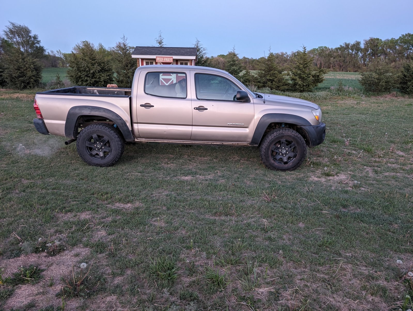

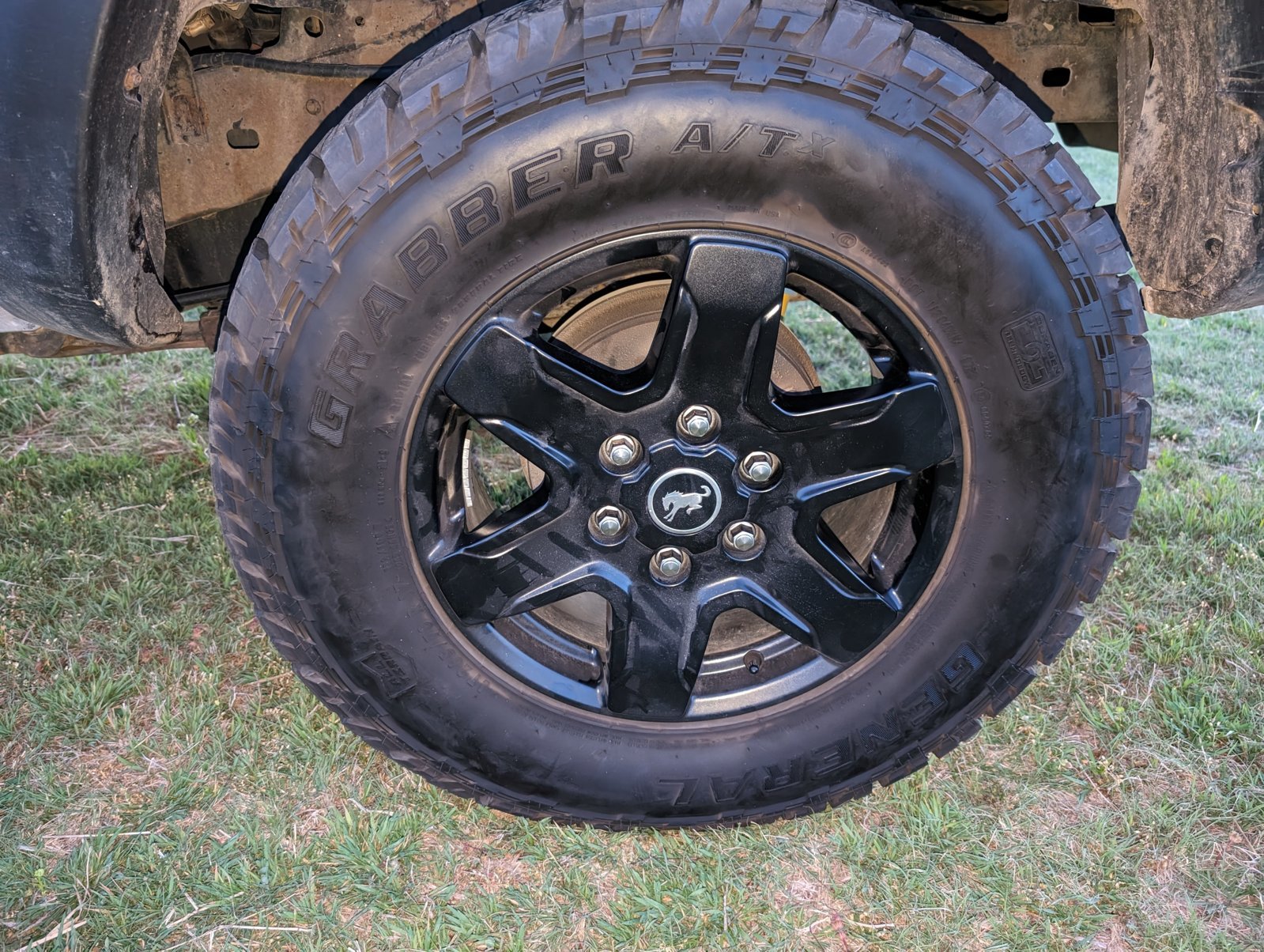

    I put Bronco takeoffs on mine. I machined out a 1.5" spacer because the hub-centric diameter on the Bronco rims is smaller, but you could probably just use a bolt-centric spacer without the lip. The Bronco rims are +63 offset so you need the spacer anyway PXL_20240422_012442424.jpg PXL_20240422_012420218.jpg

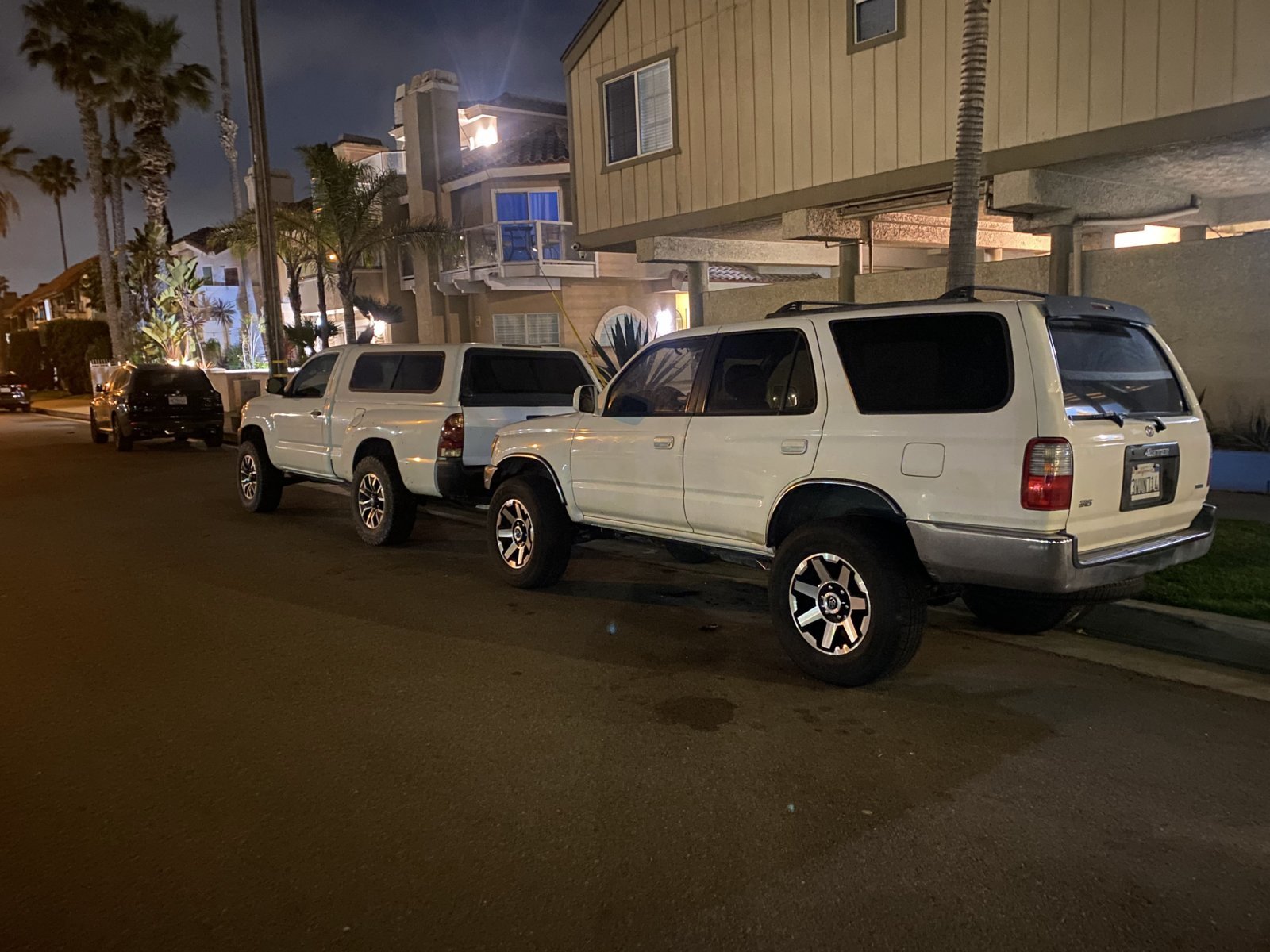

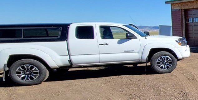

    Love the 2020+ sport wheels - I have them on mine too. The best thing about them is the holes between the spokes are big enough to put your foot in when working on the engine or cleaning the windshield or roof.
    Just a heads up they’re from 3rd Gen 2020+ not 4th Gen - 4th Gen aren’t a direct replacement for pre 24 trucks.
