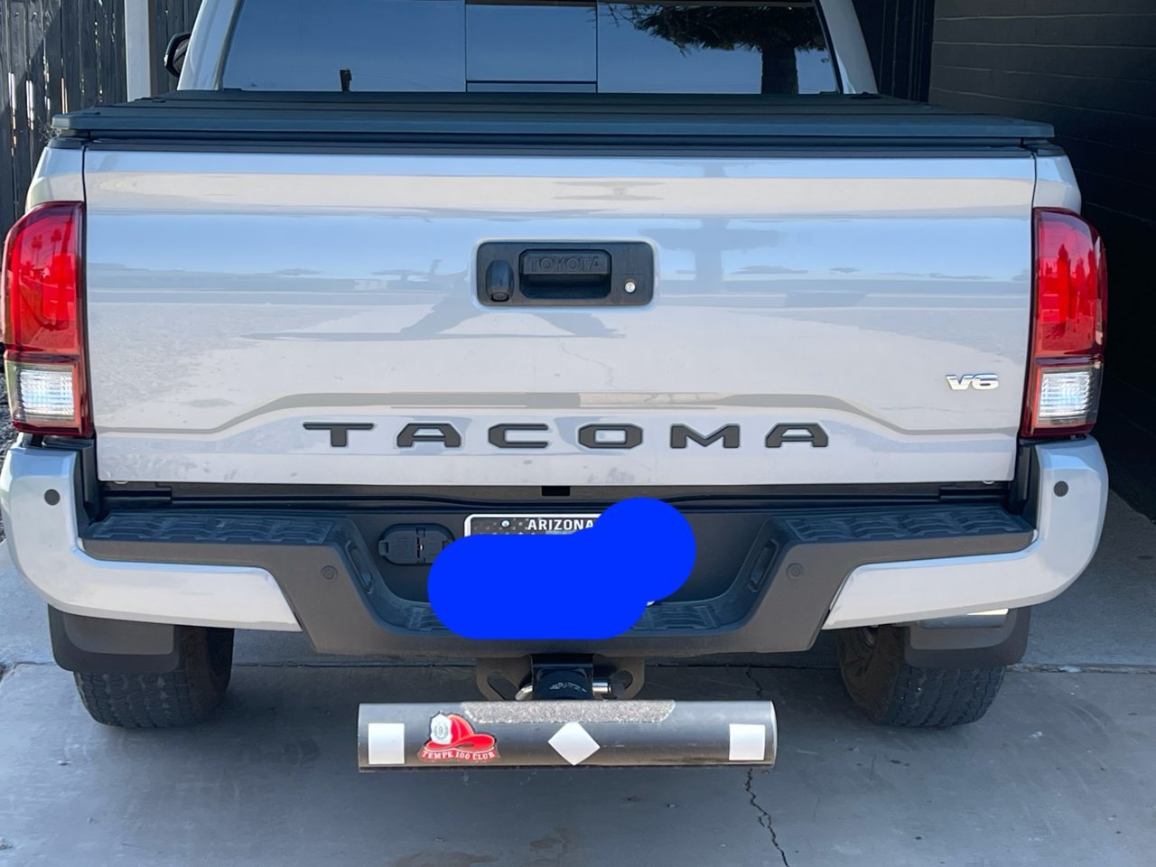

    Hello fellow Taco aficionados.
    While taking the trash bin to the curb I noticed something off about the rear of my Taco. It appears as though the bumper was damaged most likely when I was parked. There’s no body damage, bumps, scratches, etc but you can clearly see a large gap below the brake light housing. I’m guessing someone hit my super bumper and it F’d up the bumper.
    This thing is my baby and I take great care of it and I’m so pissed that some turd did this.
    Can you guys please tell me if you’ve seen damage like this before? I’m grateful there’s no paint damage and I’m optimistically hoping it won’t be too expensive to fix…..
    Any suggestions for Phx area body shops that are fair?
    Lastly- does a repair like this end up in a car FAX report or is they more for a wreck? I’m not going to be using my insurance- this will be a hit from my wallet (Unless it’s a boatload of dough)
    Thanks so much for your time and info- I really appreciate it.

    I would loosen the stock frame bolts holding the entire bumper to the frame rails, re set it and then re tighten it .
    The most probably thing that happened is no one hit your truck at all and that’s how it came from factory .

    If this were me.......I'd let it ride.
    I'd also remove the shin destroyer for a couple reasons. 1. Less pain and damage to your shin. 2. If it does get bumped, the impact leverage will have a tendency to twist the bumper down.
    Bumpers are meant to get banged, bumped, dinged, scratched......

    Not to diminish the fact that someone may have hit you and took off, I didnt notice it until I read your post. If the bumper still has structural integrity, I would leave it. Truck still looks good.

    Are you sure someone hit it? If someone hit it will have marks. I have never seen even a light hit that didn't leave some trace marks, especially if it was enough to mis align the bumper. You will also see bent brackets behind it.
    Looks like the passenger side colored bumper insert is out of wack too(near the right license plate light). Just looks like a bad alignment job from the factory.

    I don’t see any damage, but if you’re talking about how your bed and bumper don’t line up perfectly… that seems to be par for the course on 3rd gens. I didn’t notice mine until I’d had it for a month or so.
    I’d be more surprised if somebody posted up their perfectly aligned bed/bumper.

    It’s a common issue. Every once in a while a post like this comes up. Mine had it. When I told the dealer about it, they said it was normal wear and tear, and to fuck off. Same thing with my vibrating off-road hood.

    Not unusual for these trucks to have beds and bumpers out of alignment from the factory. o_O
    Several posts on the forum about it. Toyota's been ramping up production and sending out these trucks faster than free pancakes. If it really bothers you (and it would me) take it back to the dealer and see if they can re-adjust it out of good faith or under warranty as a defect. Toyota corporate might offer some help as well.
    BTW, the gap at the top of your left tailgate is also wider than the gap at the top of the right side of your tailgate. Maybe the truck was built on a Friday.:confused:
