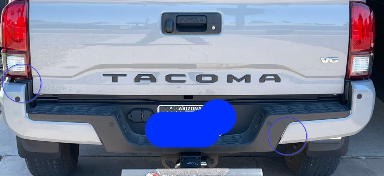

    You're concerned on the gap on the left. There's also a misalignment on the right here.
    Would be a surprise if it wasn't that way from the factory, mine looks about the same. Depending on the angle you're parked at, that's also just kinda how the bumped sits. Welcome to the third gen - still pretty damn reliable, but definitely a down-grade in some of the workmanship quality Toyota has been known for all these years.

    Just misaligned. My bed sits about a 1/2" over on the driver side. Meh, as long as I don't stare at it, it doesn't bother me.

    I had a similar issue with my 2020 OR. Noticed it about 2 months after purchasing while walking towards the back of the truck. One of those things that once you notice it your (nobody else’s) eyes keep going to it. Plus you pay your hard earned money and want things right. Took it to the dealer and they simply adjusted the bumper. No hassles or questions asked as it was obvious it was not hit. They said it was just misaligned from the factory.

    Please remember these are full frame vehicles. They are put together with nuts and bolts. They are going to have different gap tolerances than the average car. A unibody Camry may have a tolerance of +/- 3mm on a frame rail. The bumper on the truck may be +/- 3 inches when they bolt up a bumper. Temper your expectations accordingly.

    some of the tacomas come this way. It’s just a small issue with the frame tabs not being bent exactly the same. My 2016 came with it. A couple washers and it’s cherry

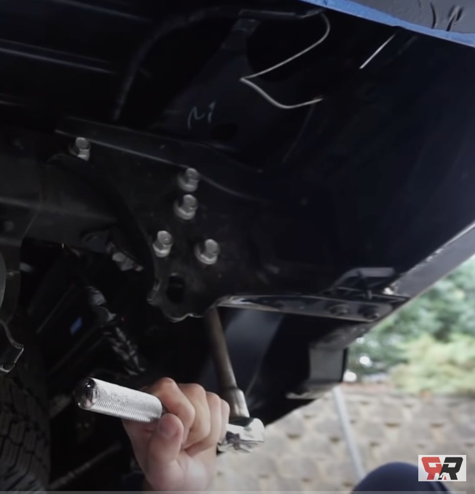

    I just replaced my bumper with an aftermarket one this past weekend. I agree with a majority of folks and suggest you loosen the 5 bolts on the left side, have someone hold the bumper up, and then retighten. I cant remember if the stock bumper had some play you could use but the aftermarket one for sure did. You can probably do it in less than 5 minutes.
    Heres a pic of the bolts I'm talking about. You don't have to touch the two located where his extension is going. Those are for a bracket that the bottom two of the five bolt on to. I believe the torque specs are 70lbs pounds for retightening.

    That thin little plastic "bumper" is beauty trim and under it is a really really thin piece of metal to support it. Fart on it and it will bend. You can disassemble the covers and then tug on the thin-assed piece of metal to level it out, then put the beauty covers back on. Your actual collision absorbing bumper is under all of that and is just fine.
