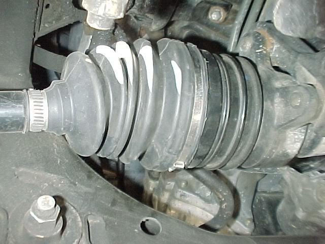

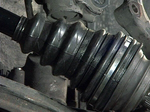

    Heres what it looks like
    note the space between cv boot ribs
    Compared to a typical oem/aftermarket boot

    cool does it use a clamp on the small end?

    Not sure, It might be like the high angle boots that dont use a clamp on the small end, you can always add one though
