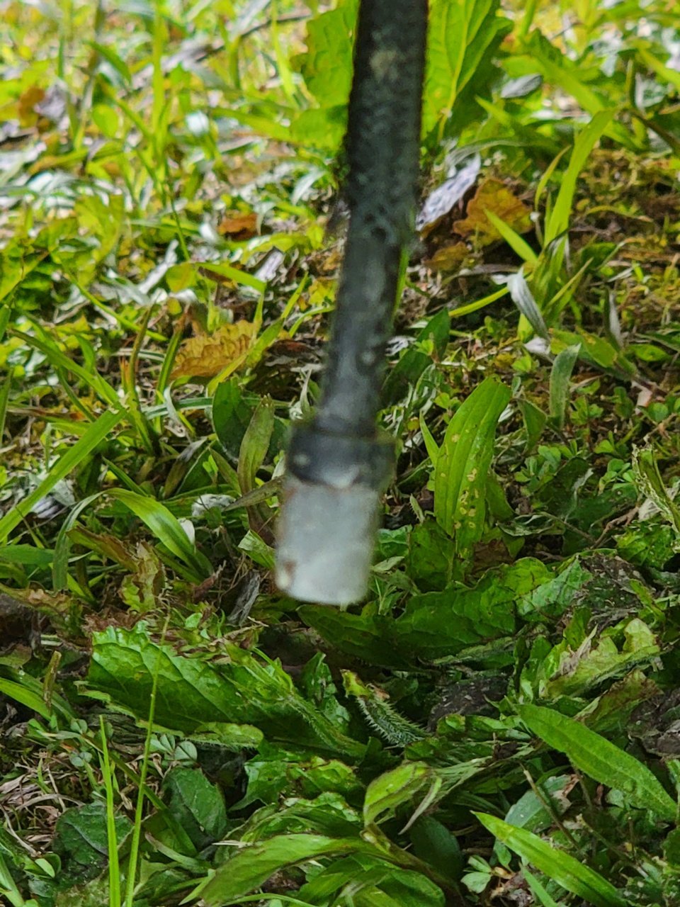

    2008 2.7L 4x4 sr5. Any ideas as to what this thing is? It's been dangling under the passenger side ever since it got the recall frame replacement. Truck runs fine so I haven't messed with it, but still would like to know what it is.

    Can you get a close up of it.....

    Sasquatch butt plug aka diff Breather

    yep vent for the diff or transfer case they never secured back
    Dayman Karate[QUOTED] likes this.

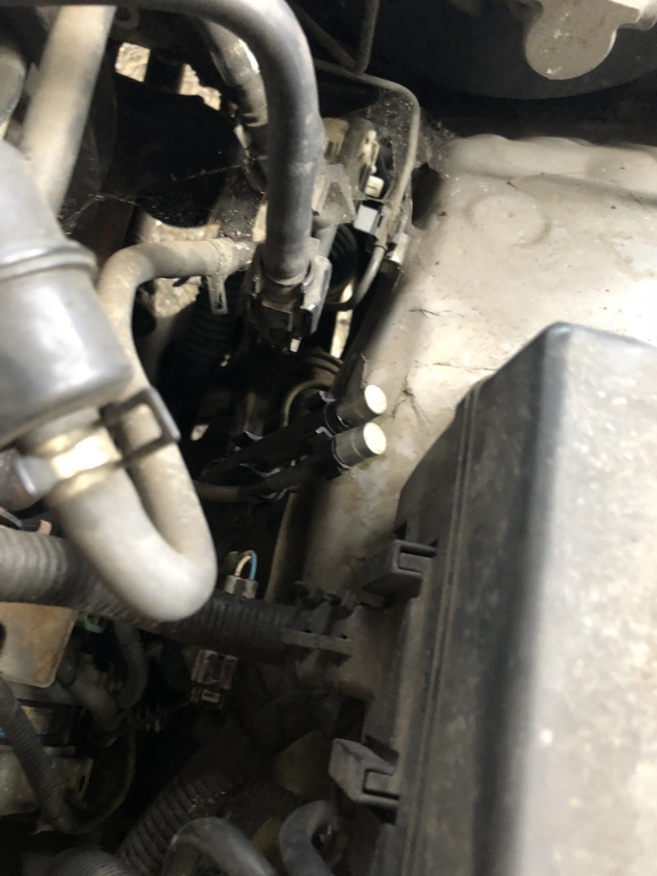

    Pop your hood and see if one of these is missing. Look just behind and to the left of the battery. If not, it’s probably the transfer case. The 2 pictured below are for the front differential.

    A breather from somewhere
    the truck has or should have added
    Breathers for
    Tcase
    Trans
    Front diff
    Rear diff
